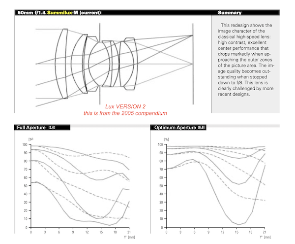

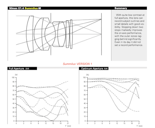

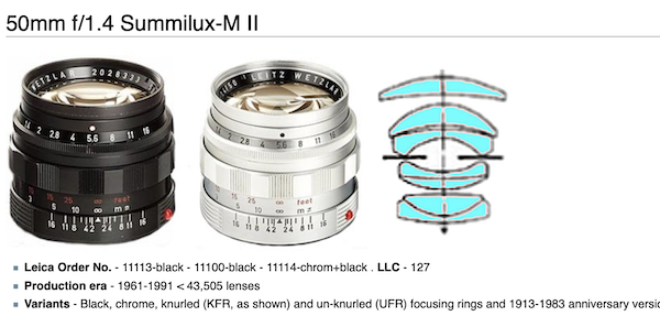

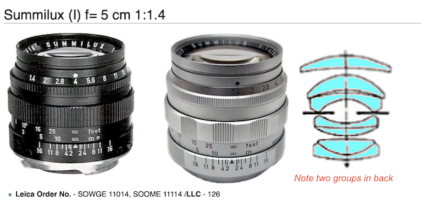

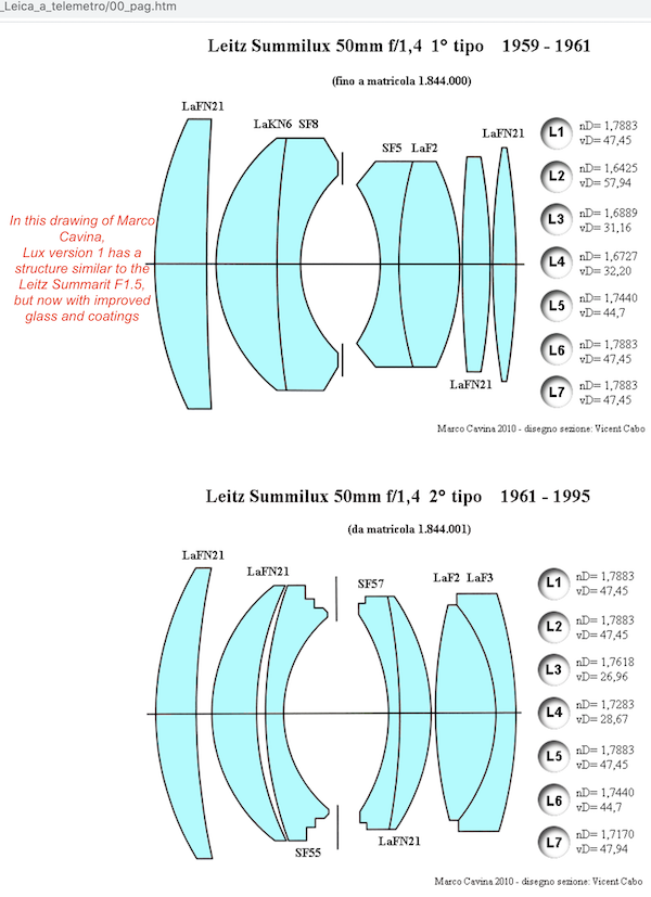

  2. Recently I have been looking at some older Leica lenses, such as the Summilux. But I am a bit confused about the versions. The information on the Leicaforum WIKI differs from the expertise that Marco Cavina sheds on the subject. 1) The WIKI gives a structure/schema for the version one similar to the version two - and just based on that, the version 1 is a good buy probably: 2) On the other hand, Cavina shows that the first version is derived from the Summarit F1.5; the basic structure is the same but the glasses and coating have been improved a lot. The structure thus is like the Taylor and Hobson 50mm F1.5. This is in line with what Puts writes in the Compendium of 2005. That makes the first Summilux in name only a good buy, in fact, it is a (good) further derivation of the Summarit F1.5 Puts: So I tend to think that the WIKI page is wrong. And my pondering on the first version has been stopped . . . {I found no way to contact the WIKI owner and I'm not an expert to change it}
