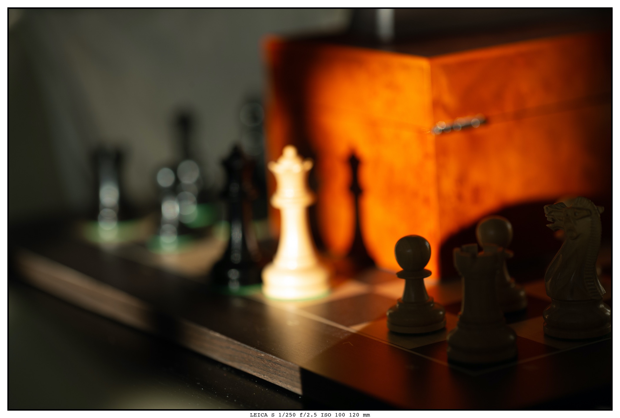

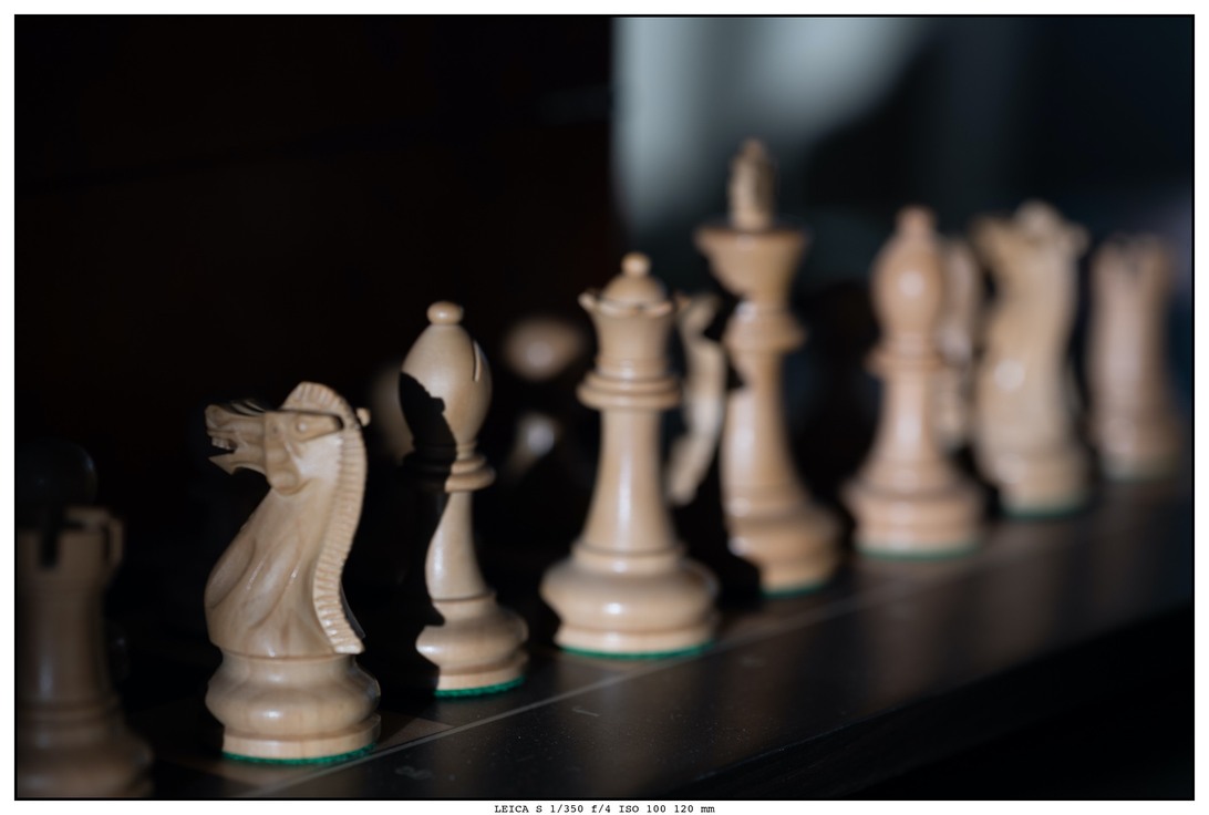

Seeking advice on whether this is the end of the road for my S 006 - hope not. At the end of a portrait shoot it stopped focusing. No sound from the AF indicated another motor failure. Sent it off to Leica and paid EUR500 to have the motor replaced. Turns out focus is still off. Could the mirror or sensor be out of alignment? I have a clear and focused image in the OVF, but the resulting images are out of focus. In the images below I focused manually on the queen, but the image shows focus somewhere else. Appreciate any thoughts on whether there is a remedy for this as I really like the S 006 look (and upgrades are too costly...).
