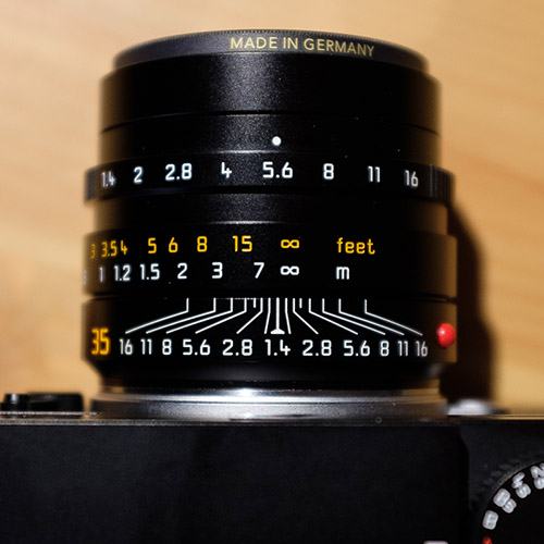

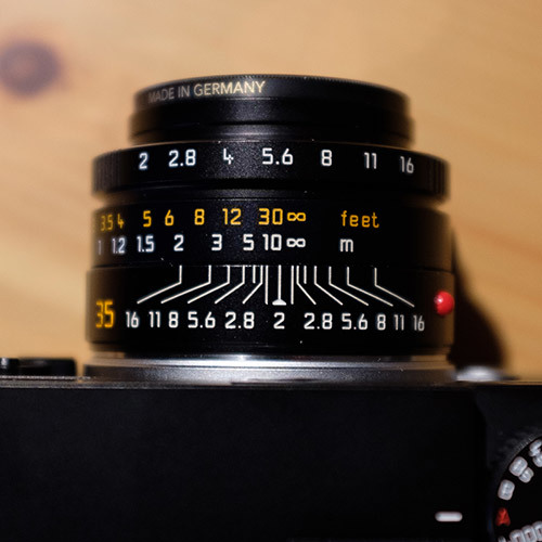

  1. I currently own the 35mm Summicron 35 asph (v1) and a Summilux 35mm asph fle. Both was recently serviced in Wetzlar, along with the camera as well (M10). All my other lenses was serviced at the same time. I am experiencing focus shift at infinity with both of my 35mm lenses. This happened before servicing, and also now after servicing, with both lenses, on the same camera body. I don't experience any focus shift at infinity with my other lenses (Lux 50 ASPH, Elmar-M 24/3.8 ASPH, Macro-Elmar-M 90/4). Summilux 35 ASPH FLE @ infinity position on the lens: f/1.4-f/2: no focus shift f/2.8-f/8: focus shift Summicron 35 ASPH @ infinity position on the lens: f/2-f/2.8: no focus shift f/4-f/8: focus shift Both lenses align perfectly with the rangefinder at infinity, but after doing some testing by focus stacking, and also using magnification and focus peaking with the EVF, I can easily detect that optimum sharpness at infinity is achieved well before the infinity stop on the lens. The exception is wide open (f/2 on summicron, f/1.4 on summilux), which focuses correctly at the infinity stop. I achieve maximum sharpness on a distant landscape scene with the affected apertures (f/2.8-f/8) at the following settings on the distance scale of the lens (see attachment of the lenses): Is this normal behavior on the 35mm Leica's? Or should I send the lenses back again? Both lenses focus correctly at other distances from what I can see. It is only at infinity that I am experiencing this issue. And if viewing an image at 100% the difference is easily seen.
