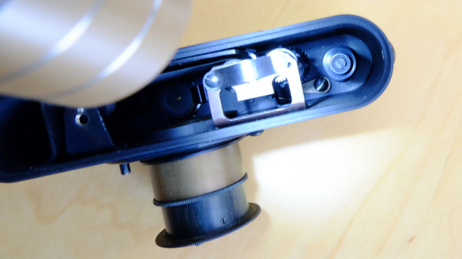

Making the film transport work - a Leica take up spool fits the diameter of the hole, but won't seat far enough down for sprocket holes to engage the sprocket. The problem is the flat head screw you can see at the bottom (to the right of the shiny silver part and to the left of where the take up spool fits. Looks like I have to remove this screw which holds the ratchet that keeps you from winding the film the wrong way. Fortunately, there's an arrow on the top side dial to show you which way to wind.
