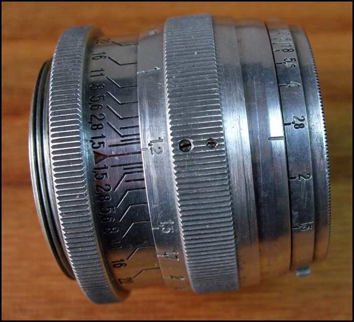

tranquilo67 Posted January 8, 2019 Share #42 Posted January 8, 2019 (edited) I hadn't see this thread before!! This is one of my favorite lenses. And, yes, there are a lot of fakes over there using Contax mount optical group over Jupiter barrels. I have a nice 50 1.5 in LTM belonging to the "obscure" serials 2859XXX. It's said that some of these late LTM were even mounted at home by Zeiss workers. A nice lens with a sad history. Mine is 534 serial numbers away from the one documented in the Zeiss Historical Society journal (Autumn 2006), and 736 number away from the famous one documented in the letter by an American soldier asking for permission to take it back home together with a camera (by the way, if any of you have an scanned copy of that letter, it would be really appreciated). I've also seen two others well documented 101 and 111 serials lower than mine. Once I'll unpack the boxes in my new house I'll post a picture of it. Best regards PS: There is a reference to another sample in the Zeiss Historical Society journal (Autumn 2001) just in case you're interested Edited January 8, 2019 by tranquilo67 Quote Link to post Share on other sites More sharing options...

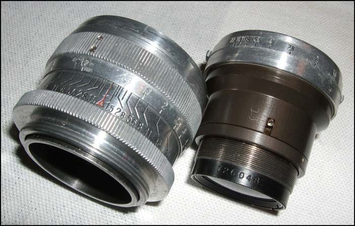

Pyrogallol Posted February 15, 2019 Share #45 Posted February 15, 2019 (edited) Since getting the ltm Sonnar at Christmas that I have learned so much more about from sabears, another one arrived today. It has an earlier serial number 2669101 and has several differences from the first. It has a black front rim, no “T” for coating, dots instead of commas for decimal points in the engravings, a dot rather than a line for the aperture index, much poorer quality engravings and the back appears to be engineered differently. The focussing mount seems to be the same mechanically as the first, though when I tried it out this afternoon it was a bit sloppy in screwing into the camera body and ended up about 180 degrees out of position with the focussing index underneath the camera body. However the three negatives I took on the end of a roll of film are in focus, so all looks good. any comments would be welcomed. I wonder if this is a later Russian takeover period lens, using Zeiss parts and a front serial number ring from an earlier period? Welcome, dear visitor! As registered member you'd see an image here… Simply register for free here – We are always happy to welcome new members! Edited February 15, 2019 by Pyrogallol Quote Link to post Share on other sites Simply register for free here – We are always happy to welcome new members! ' data-webShareUrl='https://www.l-camera-forum.com/topic/45989-zeiss-sonnar-155cm-ltm/?do=findComment&comment=3684952'>More sharing options...
