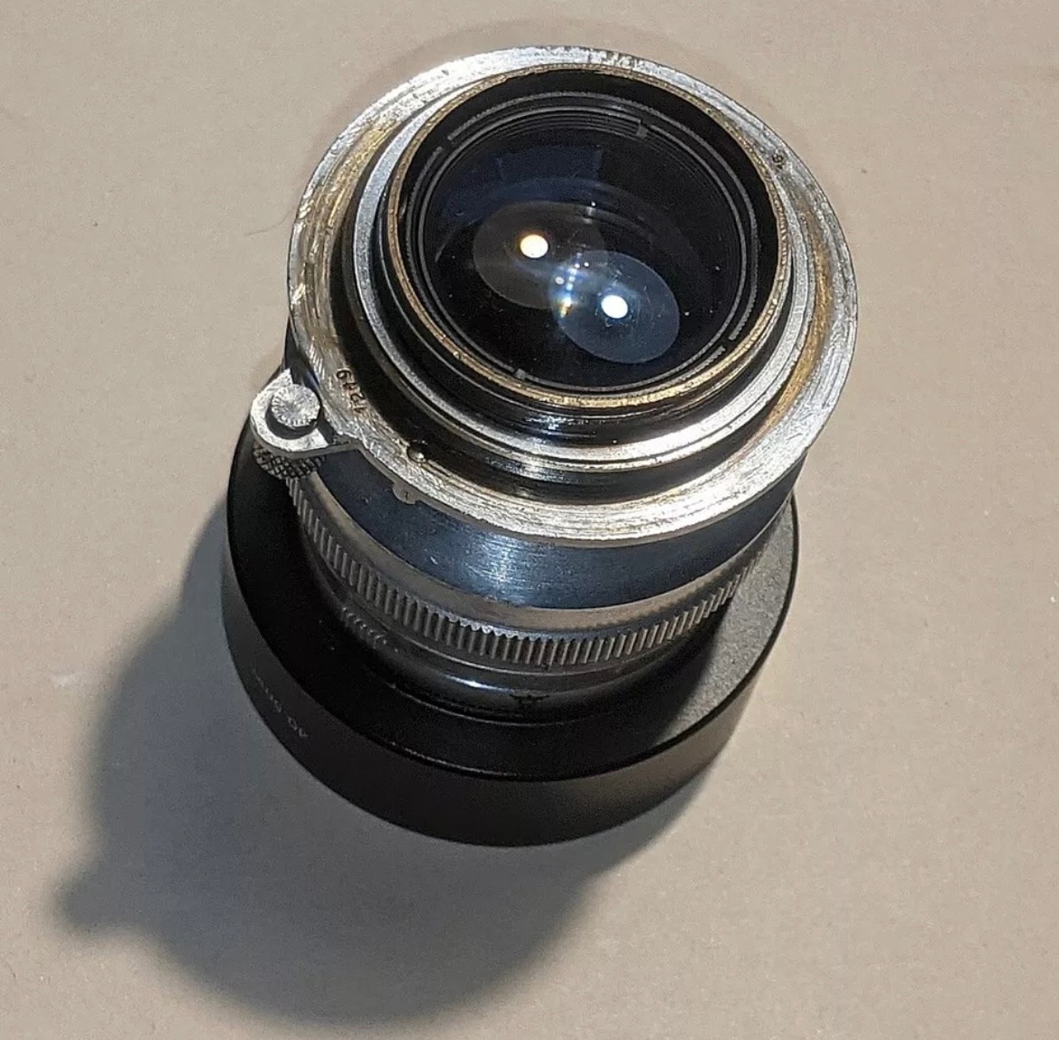

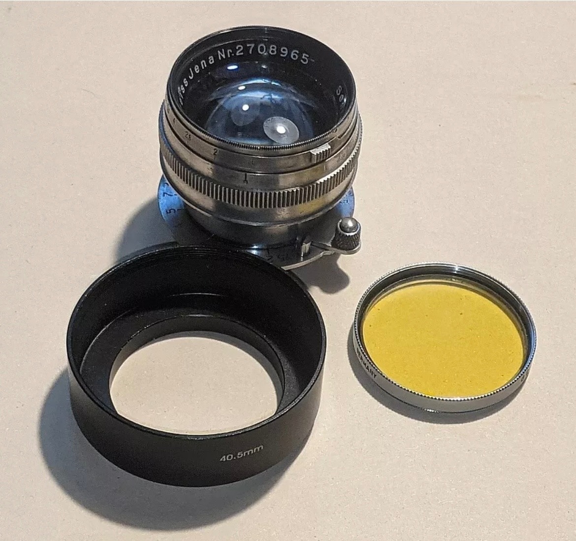

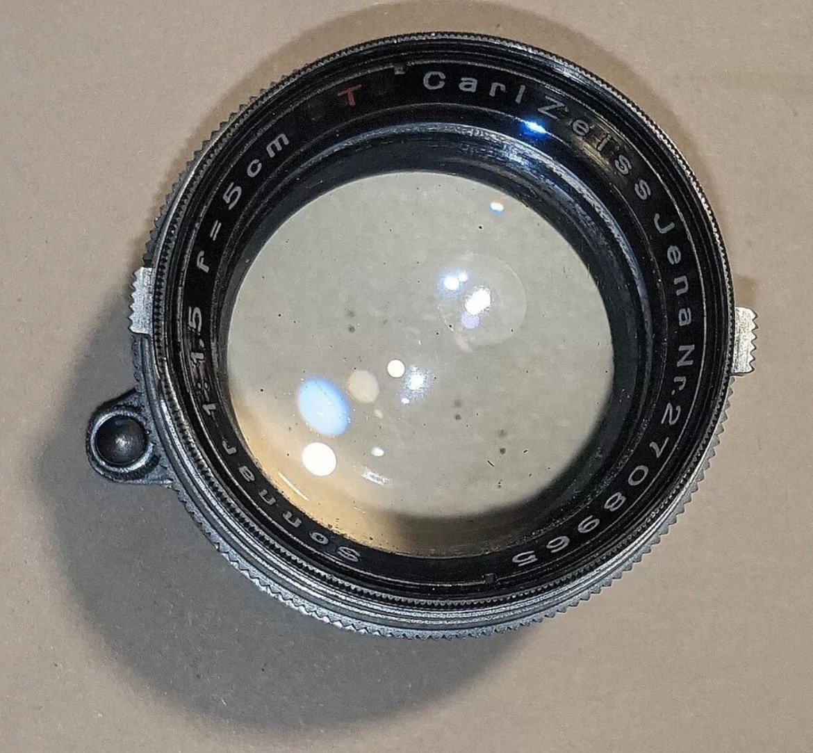

Mascarpone Posted February 21, 2008 Share #1 Posted February 21, 2008 Advertisement (gone after registration) Most of these wartime beasts are postwar fakes, from russia with love. I own an original, confirmed by a Zeiss historian. It is the type of lens "HCB" usd for years. It just received a complete CLA, and the glass has no scratches - but the old coating has some stains that my repairman can not remove. It had been used with a screwmount Leica on a german submarine during the war, the spots were created by salt water. It did not affect the glass itself, but the coating is not so beautiful. My question for the experienced collectors: is it possible to re-coat such a lens? Quote Link to post Share on other sites More sharing options...
