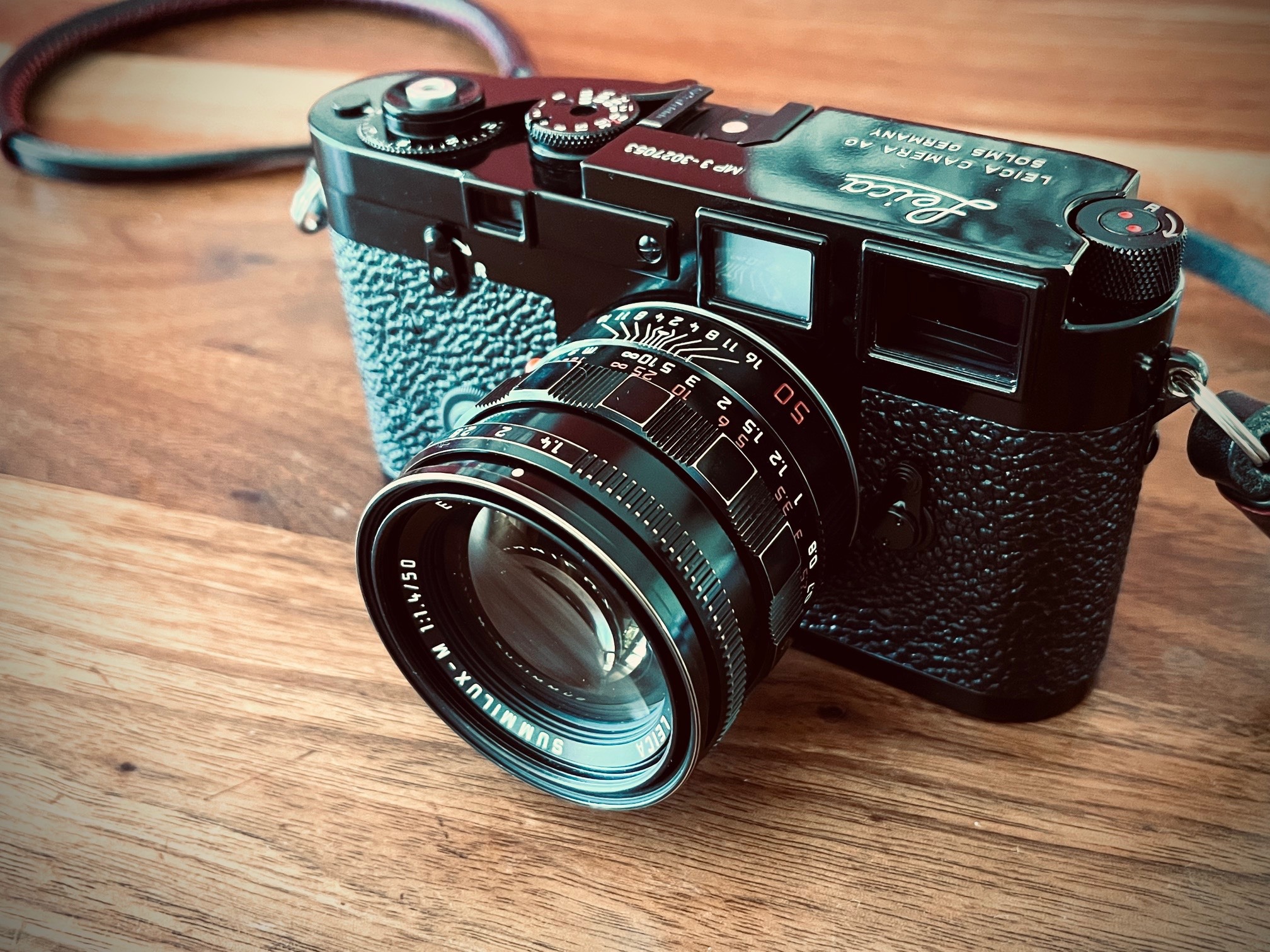

Al Brown Posted October 3 Share #1 Posted October 3 Advertisement (gone after registration) Dear experts and Leica lovers, in your opinion, what film M body was built best and why do you think so? Could be ergonomics, could be the build quality, could be the mechanism...? let us know your thoughts. Welcome, dear visitor! As registered member you'd see an image here… Simply register for free here – We are always happy to welcome new members! Link to post Share on other sites Simply register for free here – We are always happy to welcome new members! ' data-webShareUrl='https://www.l-camera-forum.com/topic/413179-which-analog-leica-m-body-was-built-best/?do=findComment&comment=5640845'>More sharing options...
