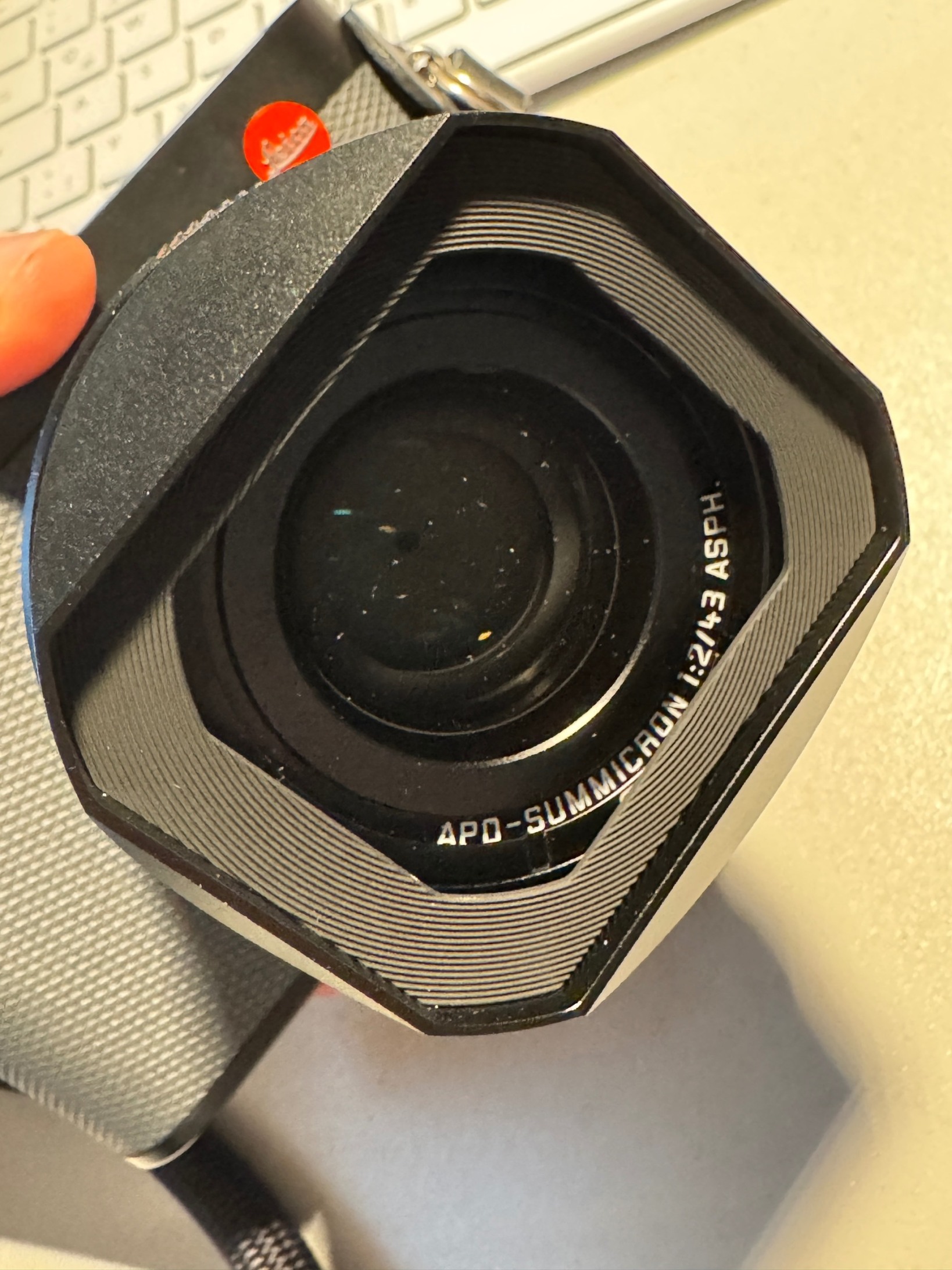

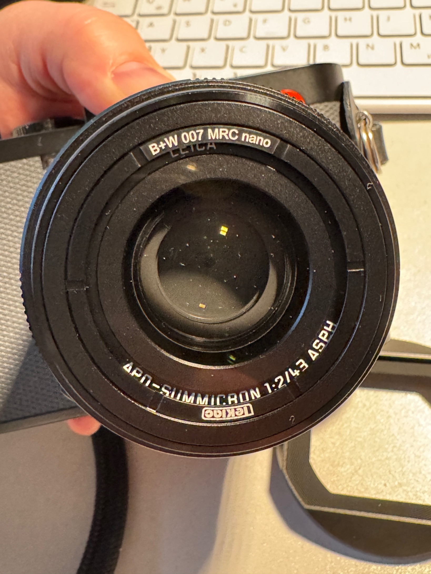

I tried the B+W XS-Pro Nano 007 which was on my old Q, and it proved a little too thick - the hood would not quite rotate all the way to the stop, leaving the hood a couple of degrees out, and the threads under strain.
I was going to order the newer B+W Master Nano 007 (recommended by others) until I noticed that its specified projection is 3.4mm - exactly the same as the XS-Pro.
Hence I ordered the c.20% more costly B+W T-Pro Nano 007, which is specified at 2.9mm projection. I can confirm that the hood sits fractionally proud of the filter, and that the hood rotates easily to the stop.

I’ve just fitted the T-Pro Nano to my Q43, it’s a tight fit but the hood does reach the hard stop.
6 minutes ago, mhasman said:
Thank you for letting us know!
Question, please - how is macro-mode with B+W T-Pro Nano 007 attached?
Forget about Macro, there isn't a filter in today's market can fit the Q3/43 with the hood and Macro engaged.
I have the B+W T-Pro line I used for my Noctilux 50/1.2 lens, I tried it on Q3/43, it works, but of course no Macro.
