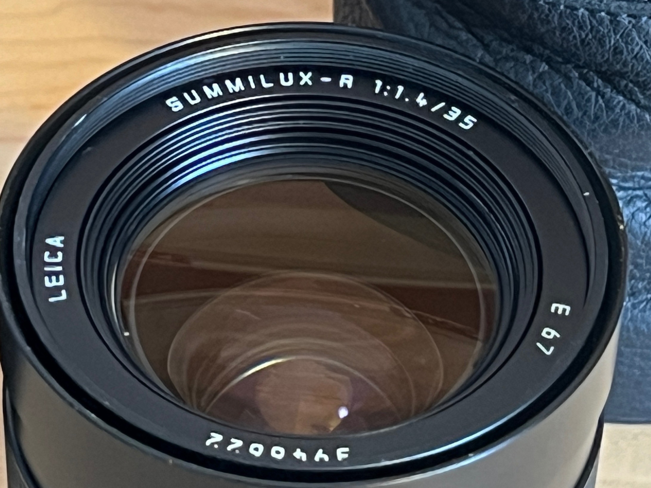

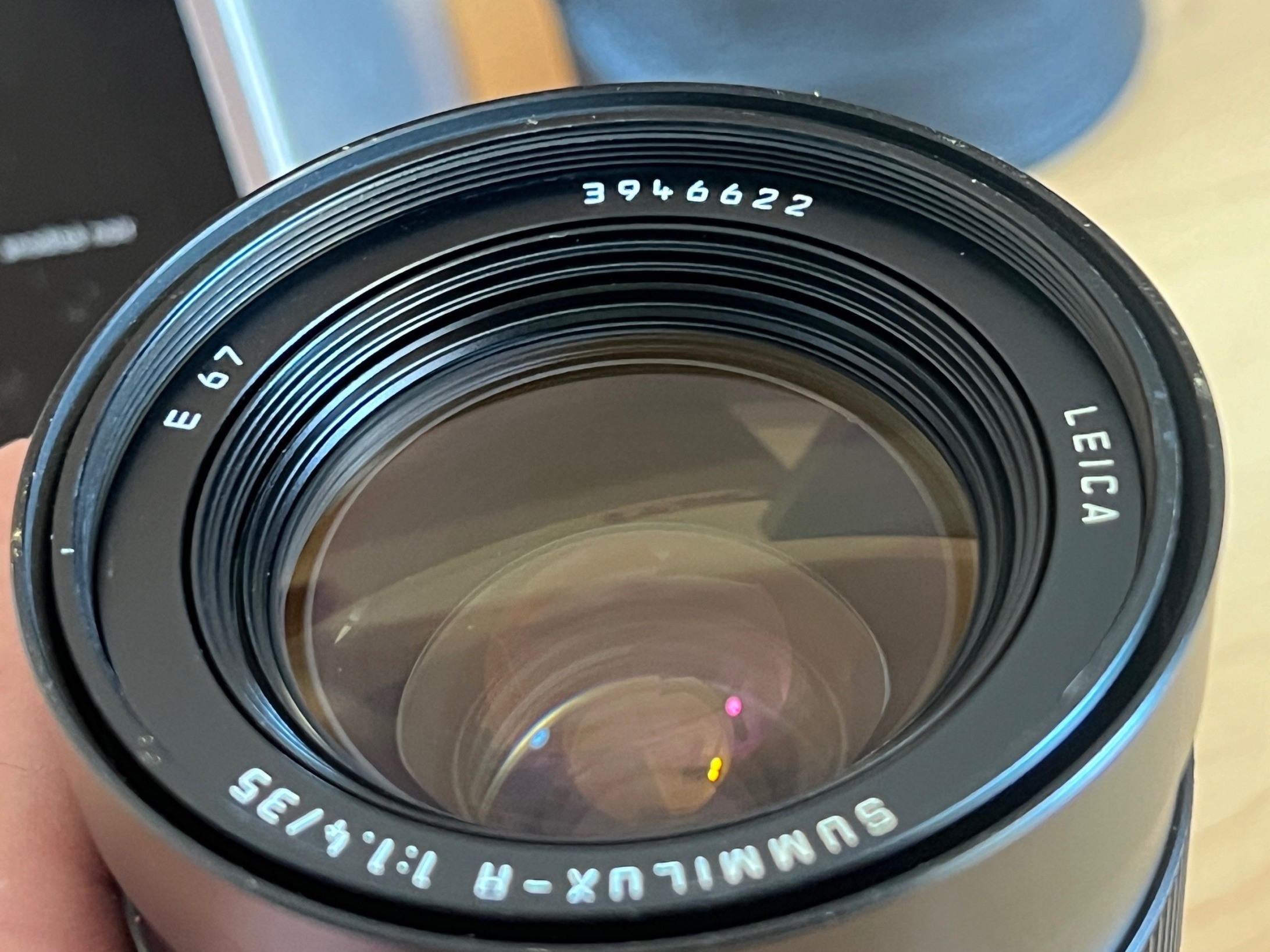

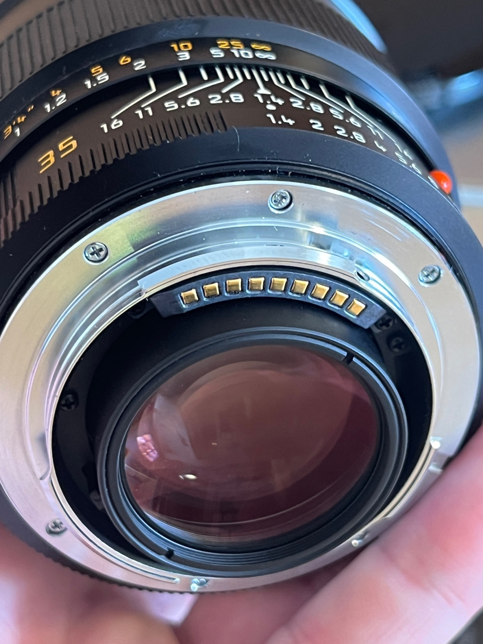

Adam_James Posted June 11, 2024 Author Share #17 Posted June 11, 2024 On 6/9/2024 at 1:18 PM, OR120 said: Please let me know how this (35 R Lux) purchase goes - I've been looking at one too - for some time - just have not been able to justify price -- good luck! The 35 Summilux-R comes in today. I’ll thoroughly inspect it as it was pretty expensive. What system will you be using it on if you buy it? I’ve kind of been obsessing over this lens, and have read countless articles, and done a lot of research on it. By no means am I an expert, but I figured out exactly what years or iterations of this lens based on this forum and lens databases. If you are looking to use it on an L mount camera, I’d look for one with ROM contacts, and silver box packaging. Cheers, Adam 2 Link to post Share on other sites More sharing options...
