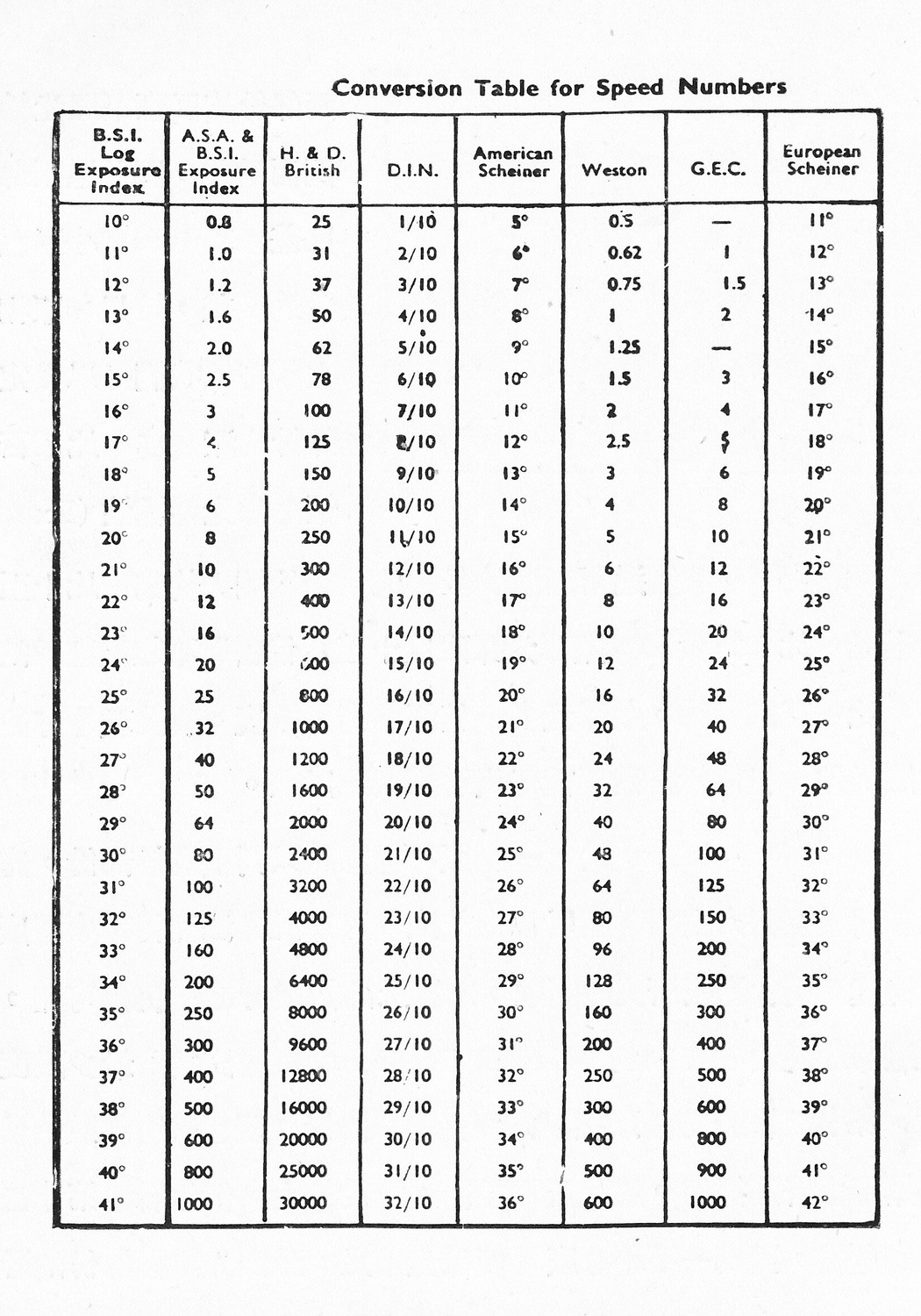

I have gone through the notebooks of a photographer which were filled out between 1890 and 1920. He simplified things for himself by always using f16 and varying the exposure time and he also always took his images between 12 and 3 pm in the day (orange or blue on the table above) while noting the nature of the available light. He used exposure tables, although I also found what looks like part of an early Watkins Actinograph in his darkroom   He also had compensating factors for his various lenses which were based upon focal length and effective aperture. He wrote these into his notebook sometime after 1888. At that time there was no standard aperture system and he actually scratched what we would recognise as the 'modern' aperture scale onto his Dallmeyer Rapid Rectilinear lens which had an earlier aperture system. The table below indicates the range of aperture systems back then. The RPS set the manufacturers on the road to standardising apertures but this only took effect after 1895
The table above is from the late 19th Century, but the following table of speed ratings for films/plates dates from as late as 1952. Some of the tables written into film boxes about sea, sunny, hazy etc conditions may take UV into account, but tests would be needed to confirm this for each historical film/plate brand.
Making comparisons between eras is almost impossible given the extent of the variations which applied, but the amazing thing is that photographers managed to great pictures right through this time. The white skies of the 1850s soon gave way to detailed skies as the sensitivity to blue got ramped up, but even they have a period charm.

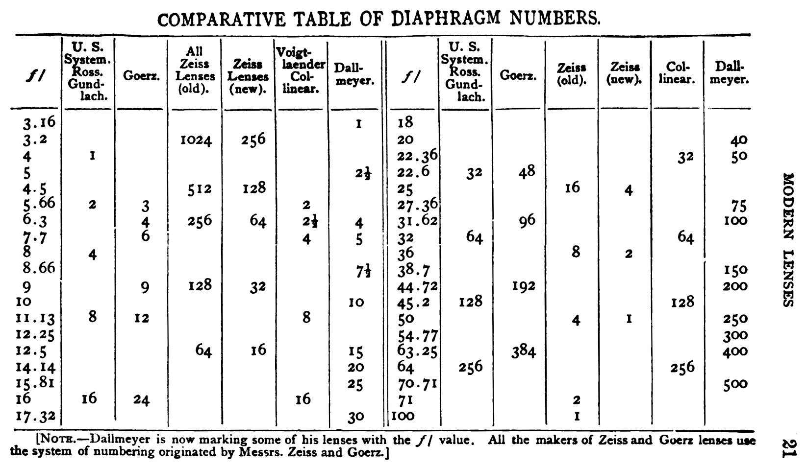

Finally, Leitz only shifted from the continental aperture system to the 'international scale' in the 1940s.
