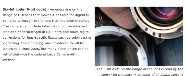

The way the camera recognize the lens, is the 6-bit code on the lens, read by the sensor on the bayonet of the camera. So if the engraving on the bayonet is not correct, it fail to read it. Or if the sensor on the bayonet is faulty it will have trouble recognizing several or all lenses. I had a Noctilux that didn't register on the camera 90% of the times, and Leica had to replace the bayonet and adjust the camera (I think it was the M240).
Seems like they didn't understand the problem or didn't have the lens to test it. Anyhow, but that is the simplicity of the recognizing the lens. Rather mechanical reading of a lens code.
You can do-it-yourself trick: Clean the sensor on the bayonet (there could be oil or dirt on it), and theck the 6-bit encoding on the lens of it looks clean and right.
Here is an explanation from my Leica Definitions:
