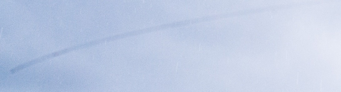

I set the focus full close and shot the sky at all apertures to check for dust. There wasn’t much but there was an odd line, like a hair, from F5.6 upwards, bottom left.
I looked at the sensor  -  and couldn’t tell if it was a hair or possibly a shutter grease spatter that had got dragged. Mild panic because I was not due near a professional sensor cleaning place before my departure a few days thereafter. So I took my life in my hands and used, for the first time ever on a Leica (I do it on my other less expensive cameras sometimes!) a wet sensor cleaning kit. First one fluid and then the other, to get rid of the smears.
The ‘hair’ remained but I did ascertain that in a long stroll taking pictures at every imaginable aperture and range, I could not once discern it in a real picture. However, my trip was to involve a lot of sea as foreground and fearing that it might show in that circumstance I changed my plans and went to London to the Leica store before travelling.

If it is indeed a scratch, and the image you posted looks very much like a grain of sand dragged across the sensor whilst cleaning -a crack would be straight-  it is not covered by guarantee unless you can prove that Leica did it.

Thank you. Interesting. I know for a fact that it cannot be caused by a grain of sand dragged during cleaning (in my care) because I had never touched the sensor (or had it cleaned) until after I noticed the problem. I wonder if it could possibly be caused by the shutter dragging a particle of some kind?
What I think most likely is that it happened during the initial repair. Leica deny that that is a possibility of course.
Edited by tashley
t is very hard to imagine a shutter doing this. The direction of the scratch is 90 degrees to the the direction of the shutter, the shutter is well clear of the sensor, the scratch is discontinuous and if the shutter had done something like this it would have been destroyed.

He said she said indeed but with the added complication that it really looks like a wet cleaning scratch and not like one caused by the stamping tool Leica uses. It must have been something like a screwdriver slipping if Leica caused it, and how to prove that? We are in the realm of speculation here.

The trouble is that I have parsed two sets of images really carefully, including finding those with as neutral as possible a background in the area of the scratch and with (reported) apertures of f5.6 or tighter. These two sets are:
1) post the first repair
2) post the discovery of the scratch
in neither set of images - other than those shot specifically to show the scratch - in other words in no ‘real world’ image is the effect of the scratch visible even with extreme processing efforts to push its visibility.

So I really would like to get the scratch fixed because one day (maybe a seascape or a snow scene) it will show up. If I can make it show up shooting a plain white window blind then it is always a risk. And then there’s the resale value issue.
Over 2000 euros is a heck of a price vs using a spot healing brush or stamp brush in LR or PS for the few images you might actually post or print. Personally I would just get the camera back and deal. That said, Leica should be more reasonable about this, esp considering how I would assume your Leica gear warranty list looks like from over the years. One customer service solution would be perhaps meeting you halfway. Sometimes this company leaves me with a bitter taste in the mouth, despite my daughter being named Leica - yes, in for life.
