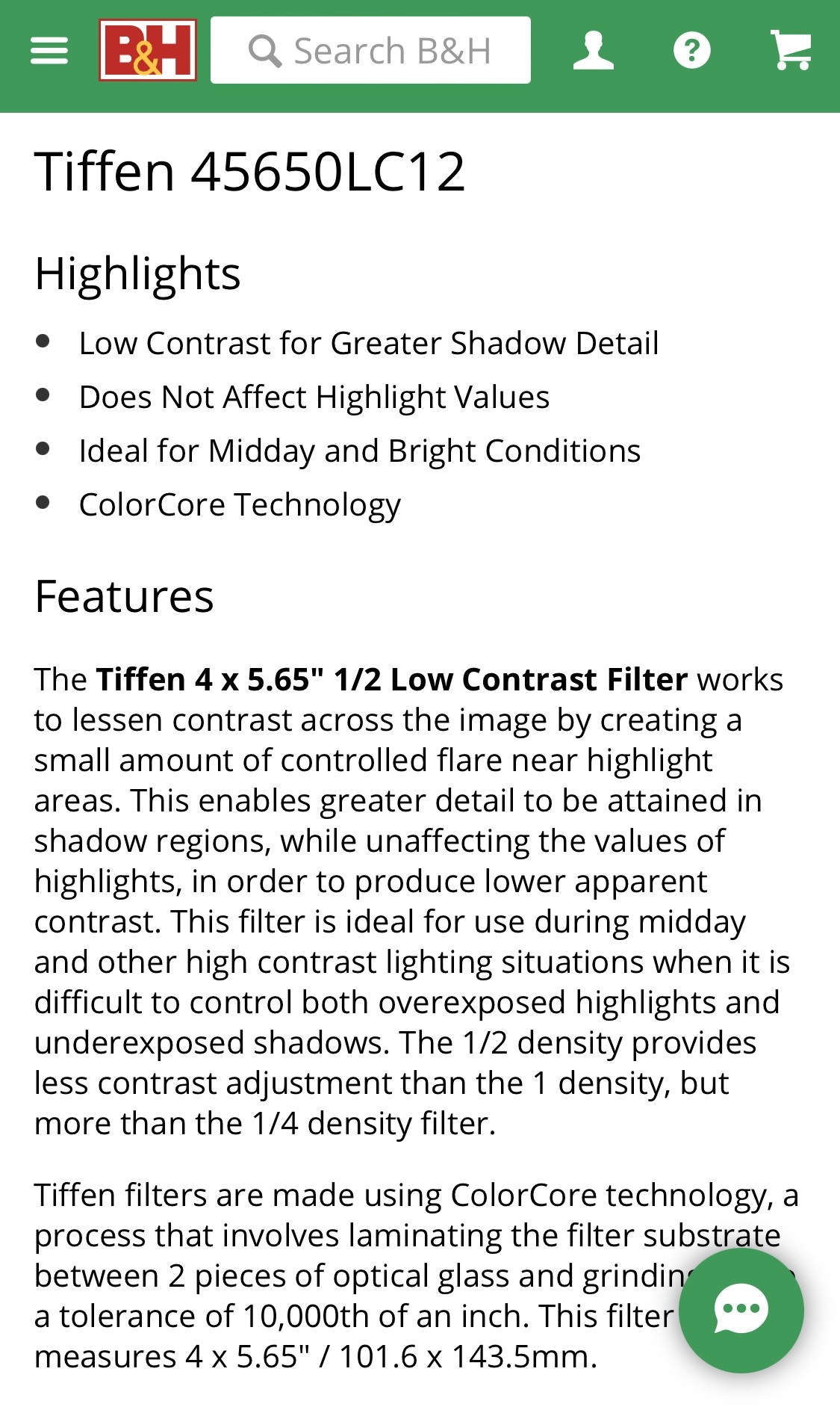

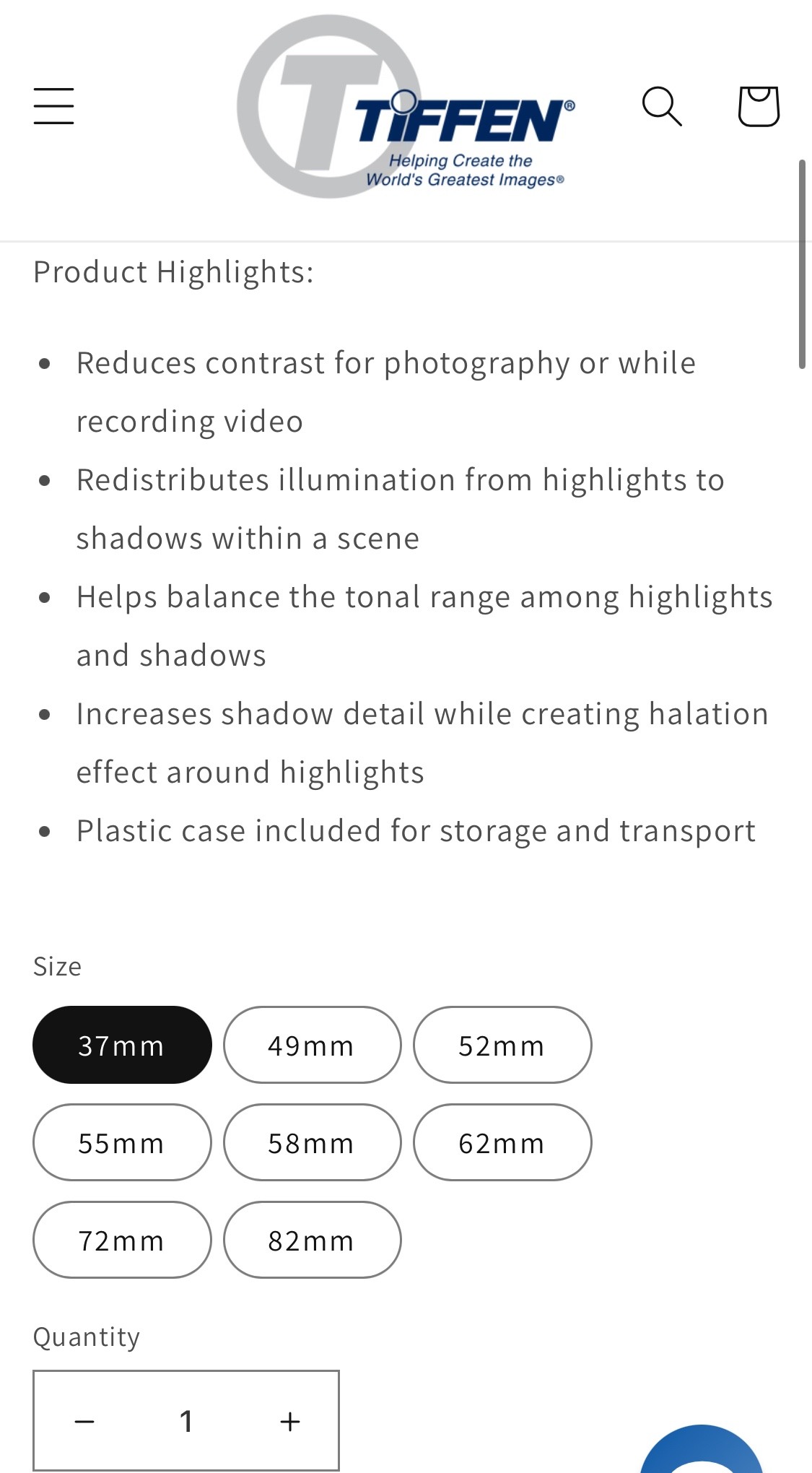

costa43 Posted September 18 Author Share #11 Posted September 18 (edited) 4 hours ago, nitroplait said: Isn't there a contrast slider that goes "negative" as in; reduce contrast? If the lens captures a long tonal range and details, then adjusting contrast in post (digital) or in the darkroom through VC filters shouldn't be a problem - or am I missing something? It’s not the same for me. Especially on sunny days when shooting into the light, I find lower contrast lenses retain more detail in the shadows and give you a look that I cannot replicate so easily in post. I also prefer them for b&w pics. Edited September 18 by costa43 JMF, KFo, ocean2059 and 1 other 2 2 Quote Link to post Share on other sites More sharing options...
