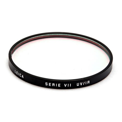

I know several people with the 35 pre asph Summilux where you have to mount the filter in the hood, designed for a series 7, but a B+W or Hoya 49mm works too. Some cheap 49mm filters don't fit, I am not sure if there was a series 7 IR/UV made for this lens (hood).
Yes there is or was a Leica Series 7 UV/IR filter definitely (13421 below). I got one when the M8 was released but i don't know if Leica still sells it nowadays. A couple of them are available right now on e**y including an affordable old stock in Germany. BTW dropping upside-down E49 filters can help with the 12504 lens hood.
vor 7 Stunden schrieb lct:
The 49mm don't have to be upside down, B+W filters fit either way. Both ways they don't tighten all the way, but they are secure. I'll have to look for a series 7.
