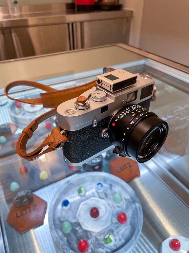

Anyone using on-camera light meters like Keks on film cameras? What are the advantages comparing to the light meter built in the camera?
Also, does the additional bulk added to the camera bothers you? I like the naked camera and I generally don't like to add anything except the strap, but I'd like to hear about your experiences with this meter, so maybe I can find it's use in a certain situations.

Yes, I have MP. I thought maybe this meter provides functionality that in-camera meter doesn't.
Leica’s built in meters work well but it’s understandable you’re looking for just a bit more. I really like my Sekonic L-308 but it is a bit large. The Gossen Digisix II would be a good choice. Easily slips in a pocket, accurate, offers both reflective and incident metering plus a few bonus features. It has a digital readout in EV and an analog dial that shows both shutter speed and aperture. It also has a timer, clock, thermometer and and averaging mode.
It would be a fine companion to your MP, small enough to take along for the times you want a meter but not taking up space on your top plate.

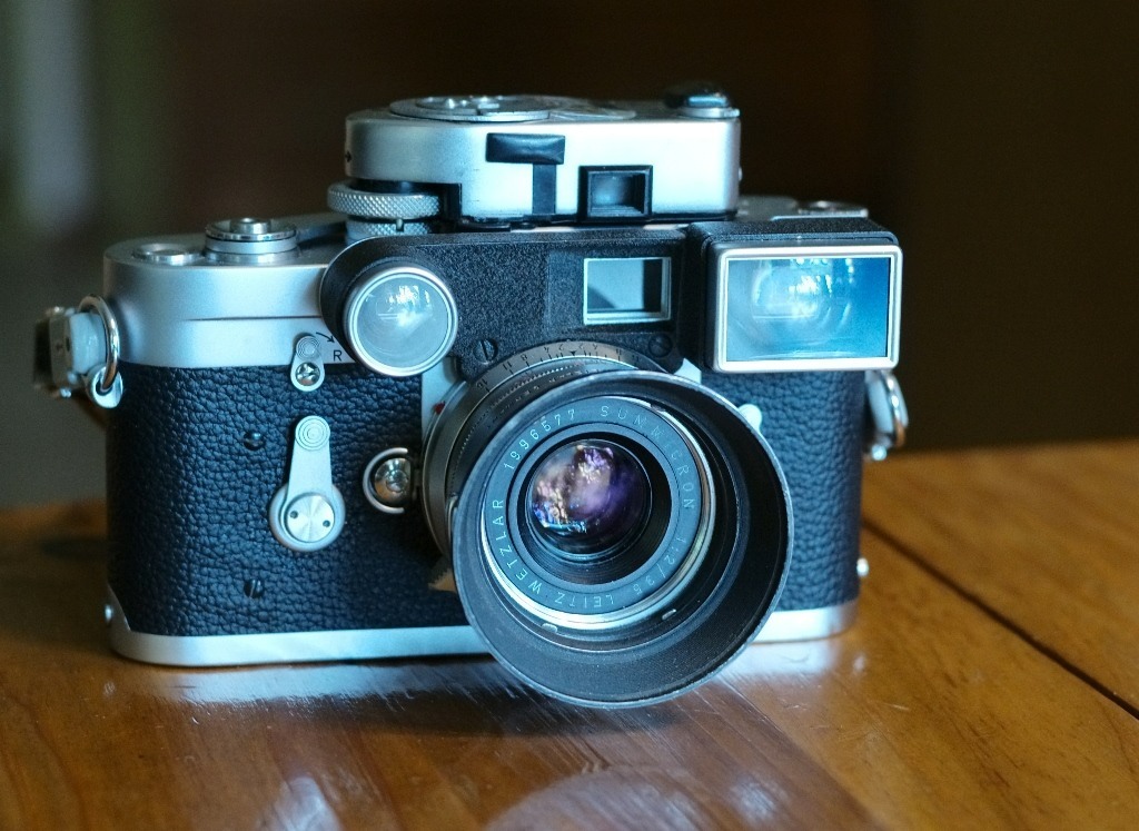

I used to have MR44 meters for my M bodies, then I excitedly got an M6TTL thinking how convenient that would be without an external meter. The fact is I really hated it. These days I either use an external meter for incident light readings or merely use the Sunny 16 rule on my Leica M and Barnack bodies. Most of my other camera bodies have built in meters which generally work just fine in spite of being aged (like me).
For my meterless cameras I use either a Sekonic L398 (battery-less) or Photo Friend, a smartphone app, that takes a picture of the scene (and histogram) and gives an exposure from that. The advantage is that I can see if it has been biased by bright lights or widespread shadows.
The Sekonic is simple, can live in my pocket, and can be quickly used one-handed as lighting changes. The phone app is always with me - I don't have to remember to take it.
I had a MC meter or MR4 meter on my M2, but always resented the bulk, and never understood it well enough to get reliable exposures (my fault - I just didn't put the effort in).
