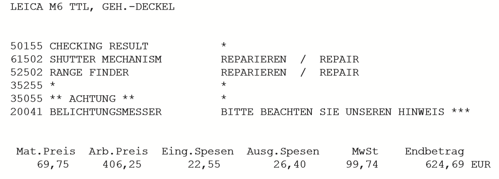

Telemetric Posted February 24, 2023 Share #1 Posted February 24, 2023 Advertisement (gone after registration) Good night, I bought a Leica M6 TTL AND i sent it to Paepke in Germany for a CLA. . Yesterday I received this email and... bad news: Enclosed you will find a repair quotation for the faults you have indicated in your Leica M6 TTL. As a further complaint, we have found that the exposure meter does not work reliably. The circuit board shows moisture damage. Unfortunately, it is no longer possible to repair the light meter. The damaged component is no longer available. German text In der Anlage erhalten Sie ein Reparaturangebot über die von Ihnen angegeben Fehler Ihrer Leica M6 TTL Als weitere Bemängelung haben wir festgestellt, dass der Belichtungsmessung nicht zuverlässig arbeitet. Die Leiterplatte zeigt einen Feuchtigkeitsschaden. Eine Reparatur der Belichtungsmessern ist leider nicht mehr möglich. Das beschädigte Bauteil ist nicht mehr lieferbar. But surfing the net I found this: Welcome, dear visitor! As registered member you'd see an image here… Simply register for free here – We are always happy to welcome new members! So I think if I send it to Leica they will repair it. Today I have written to Leica Germany. I will let you know if they can repair it. Quote Link to post Share on other sites Simply register for free here – We are always happy to welcome new members! So I think if I send it to Leica they will repair it. Today I have written to Leica Germany. I will let you know if they can repair it. ' data-webShareUrl='https://www.l-camera-forum.com/topic/368353-lightmeter-for-m6-ttl/?do=findComment&comment=4698521'>More sharing options...

Telemetric Posted February 24, 2023 Author Share #2 Posted February 24, 2023 (edited) I have news. They answered me that they will repair the M6 TTL lightmeter (well, they will install the lightmeter of the “new” M6) starting this next july and the cost will be about… 1.600€ So, we will be able to repair it but at a very expensive cost. Edited February 24, 2023 by Telemetric 1 1 Quote Link to post Share on other sites More sharing options...

Telemetric Posted March 1, 2023 Author Share #18 Posted March 1, 2023 Well, is official. I just received this mail from Leica: At the moment we can not carry out any repairs on the M6 and M6 TTL concerning electronic parts because they are not available anymore. We will offer un upgrade by the middle of this year to the new M6. The top cover including all electronic parts will be exchanged. Please contact us again later this year. I am sorry for not heaving a more positive answer right now. Quote Link to post Share on other sites More sharing options...
