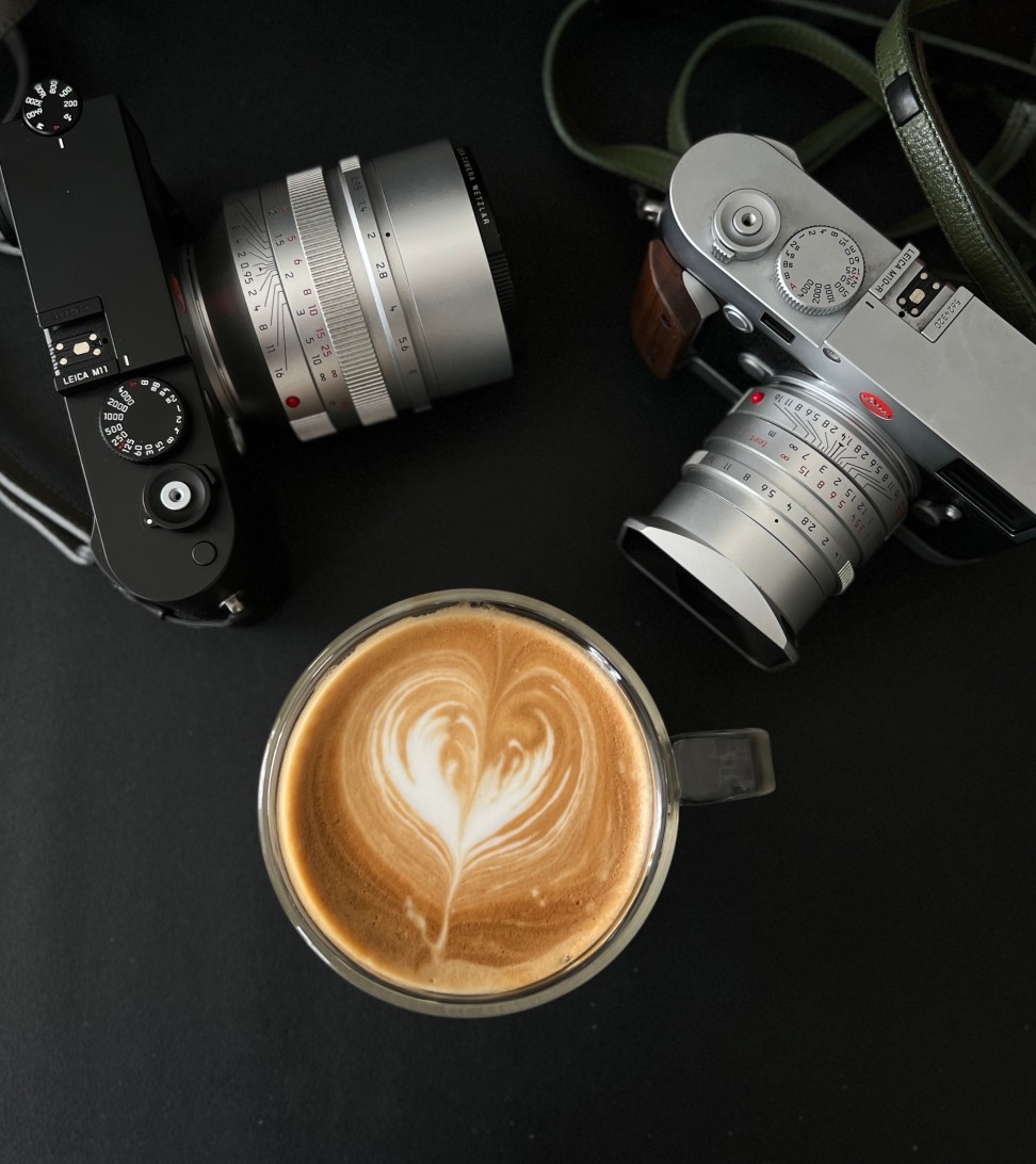

hmzimelka Posted January 23 Share #3 Posted January 23 The M11 does really well for long exposures, but be weary that the lens mount can leak light. I thought my camera was defective at first but it isn't. Confirmed by users on the forum and trying out other cameras myself. I use a hair band around the lens, stretched around the lens mount, and this prevent this light leak. My worst offender is the Summicron-M 50mm V, but the rest of my Voigtlander lenses are mostly OK. Keep in mind this was with a 10 stop filter and sometimes with an additional polariser attached. While the image below holds zero artistic merit, it's a 900sec exposure without LENR. Very few hot pixels. Welcome, dear visitor! As registered member you'd see an image here… Simply register for free here – We are always happy to welcome new members! Patrick Morgan, itsrishabh and Vonnie 3 Quote Link to post Share on other sites Simply register for free here – We are always happy to welcome new members! ' data-webShareUrl='https://www.l-camera-forum.com/topic/362957-m10-r-or-m11-for-long-exposure/?do=findComment&comment=4655396'>More sharing options...
hmzimelka Posted January 23 Share #4 Posted January 23 The scrunchy around the mount... Welcome, dear visitor! As registered member you'd see an image here… Simply register for free here – We are always happy to welcome new members! The image... 120 seconds. ToddP, Vonnie, itsrishabh and 2 others 5 Quote Link to post Share on other sites Simply register for free here – We are always happy to welcome new members! The image... 120 seconds. ' data-webShareUrl='https://www.l-camera-forum.com/topic/362957-m10-r-or-m11-for-long-exposure/?do=findComment&comment=4655402'>More sharing options...
