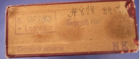

some Leica IA had lugs originally, but the lugs are different than in later III and slightly lower positioned. These IAs are rare and thus very collectible. Box in which camera has been shipped from the factory has a special stamp "Oesenkamera" which means camera with lugs.

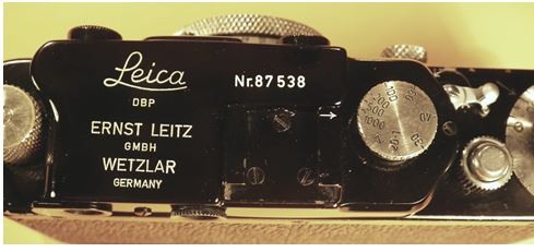

For those of you who wanted pictures I was able to grab a few. The sticker on the bottom of the camera is really wishful thinking from 1999. I have no idea what it is worth and frankly don't care as it will be passed onto family when I am gone.
LDBennett
54432 was  I model C from 1931, with interchangeable lens. Conversion to III must have happened past May 1933 but before March 1936. Having a photo of the bottom of the camera with bottom cover off could possibly narrow this time gap.
Elmar lens had originally 11 oclock mount without infinity lock. Lens has been converted as well, possibly at the same time, and received 7 oclock mount (and was standarized if originates from 54432). Mechanical build up of optical cell and engravings on the front ring indicate that they could be from original lens.
Camera and lens were non-standartized, lens must have been carrying last 3 digits of camera serial number, they were engeaved on DOF (Depth of Field) scale. Very often, during conversions of lenses Leica left original DOF ring and just engraved small "0" nearby focusing knob. Is there and 3 digit number (besides aperture numbers) engraved on DOF?

"0" under infinity lock lever means the real focal length, zero means 50,5mm. This focal length is typical for early Elmars. Left photo belows shows an example of the position where this number was engraved. Middle photo shows another "0" - this means that lens has been standartized. This shall be as well of your lens as the similar "0" is on the lens flange (at 12 oclock) on the camera. Right photo shows an example of lens that was originally non-standrad (and belonged to the camera with serial number "XX438".
Again I have to point out that the frame of the camera under the top cover had a serial number that was NOT the 54432 number and had scratch marks through it in a poor
Scratching the number under the top cover was typical procedure applied at Leica for approx 99% of conversions from IA and IC to II and III. Here is an example of such scratching, camera number is 33232.
The scratched out number makes no sense to me unless two cameras were made into one.   as mentioned above scratching was typical procedure and does not neccessarily means that two camera have been "married".
Photo of the bottom of the camera could possibly help in determining when conversion has been performed but will not help in clkaryfing the mystery of another serial number under the top cover
