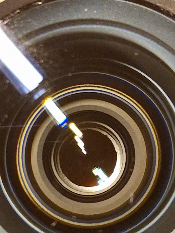

today I received my new 21mm Super-Elmar-M 1:3,4/21mm ASPH. and I have a quick question if it's normal that the aperture blades are visible wide open at f/3.4? Maybe someone with the lens can quickly check if this is normal. Otherwise the lens seems to function and operate just fine.
Sorry for the bad image quality. 😅
This is at f/3.4
And at f/4
Many thanks
Rico
Edited by Rico

I have the 21 SEM and the aperture blades are visible when wide open in the same way as in your image. So your lens is perfectly OK.
They look very, very slightly stopped down. Mine are visible, but more open. It’s only a really small amount.
I don’t think it’s worth worrying about. As long as your wide open bokeh balls are perfectly round you’ll be fine.
Look from the back of the lens - I’m sure you won’t see the aperture blades, that’s what matters.
Some lenses have other circular baffles that effectively create the maximum opening (not necessarily this lens, I don’t know!). As long as the aperture blades open to that point (or beyond) it doesn’t matter, even if you see the blades from the front. (e.g: Canon 17-35/2.8L would appear to stop down as you zoom to 17. It was actually maintaining steady 2.8 and the blades were clearly visible from the front - but from the back, the opening remained circular because of a circular baffle in the design)
@PCPix unfortunately I see the blades also from the back of the lens. And I was able to trigger at least one bokeh ball which shows a non-perfect round shape where you also can see the the jags of the blades.
Mostly the bokeh looks pretty a-ok and smooth though.
Not sure if it really bothers me much as the lens is not intended to be used as bokeh machine. Maybe it just doesn't matter.
But it's my second (quite expensive) Leica lens which has a defect newly bought. That is not so nice. 😭
Maybe I go to the local Leica shop and show it to the dudes.
There seem to be some variation between samples. Mine looks like this:
Small dents visible, but maybe smaller than in your image. And I can see the aperture blades from back as well. But I'm not sure I can see the effect of the small dents in test shots.
This is in case perfectly fine for me, because I often shoot slightly stopped down and then the blades are visible anyway in OOF highlights.

Hi Rico,
If you move the aperture ring just a tad from f/3.4, the opening becomes circular. In some copies, the f/3.4 aperture is over-extended.

Ditto with my lens
21 hours ago, Fred Miranda said:
Hi Rico,
Ditto with mine.

Hi Fred, I don't notice much of a change when I move the aperture ring. Not sure but might still be the case. Hard to say tough.
Thanks for the picture @mujk. I agree that there seems to be some sample variance. And it's hard to trigger big bokeh balls anyway with this very wide and not so fast lens.
