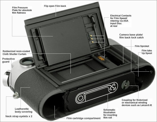

Since the 1960s I've used hard black Arkansas stones on problem pressure plates. They are used to sharpen surgical blades and can provide a mirror finish. Probably close to 9,000 grit equivalent. Flat stone on the flat plate keeps it flat and can remove any protrusions that could scratch.
I could see perhaps using that on an old camera bought used.  But this is a brand new fresh out of the box warrantied camera.  And some of the scratches appear to come from the pressure plate screws.

I don’t shoot film. So to make it clear for me, what area are we talking about that can scratch the film?
The most common place seems to be the Film Pressure Plate (see the label at the top left of the photo).
The pressure plate should actually barely touch the film, as it rests on the outer higher rails and the film rides between these rails on two lower rails making a channel for the film under the plate. I wonder if the height of rails is an issue on the new cameras.
