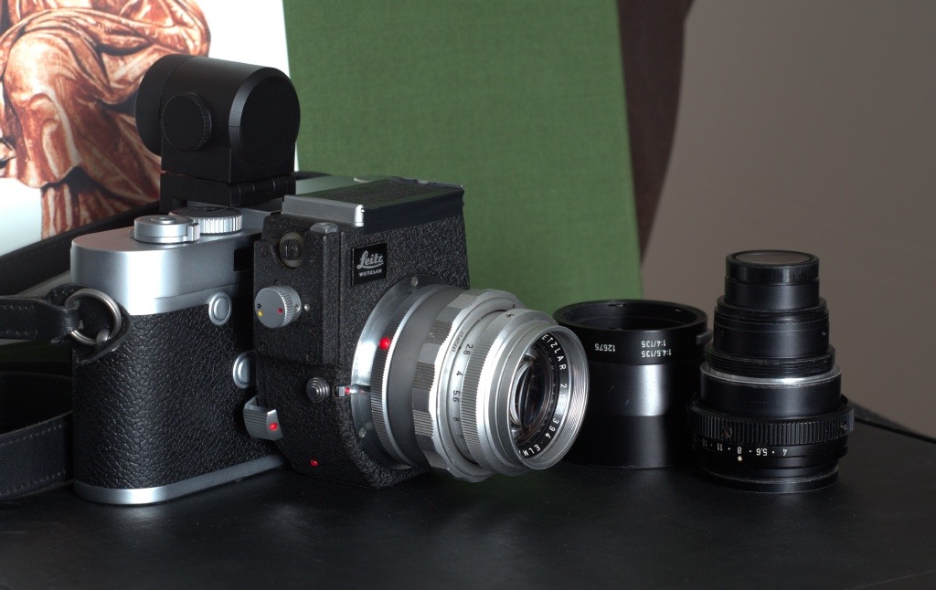

Now that @UliWermentioned it,
I need to admit that this one is "hiding gem".
Many years ago,  I had found one and out of curiosity wanted to use this Elmarit (long) 2.8/90mm.
I fell in love and bought another one of another color, black anodized, first one is silver.
For so long I didn't use them, so I wanted to retry.
Mount it on my M6, what a good balance and the focus ring at right place with smooth and precise movement.
Even the "90" framing lines are "free" (I compared to the Summicron-M 90mm a bit later, hiding frames as usual ).
The aperture is the roundest closing (I think it's 15 blades), so same round aperture as Elmar 4/90.
Some years ago, I wanted to compare lengths of 75mm and 90mm,
Elmarit 90mm, Tele-Elmarit "thin" 2.8/90mm and 2.5/75 Summarit-M (very good lens)
side note,
the unscrewed optical cell can be useful as experimentations,
here with M10+optical Visoflex III (+ variable focussing ring OTZFO...)
another "use" a bit lighter 😉

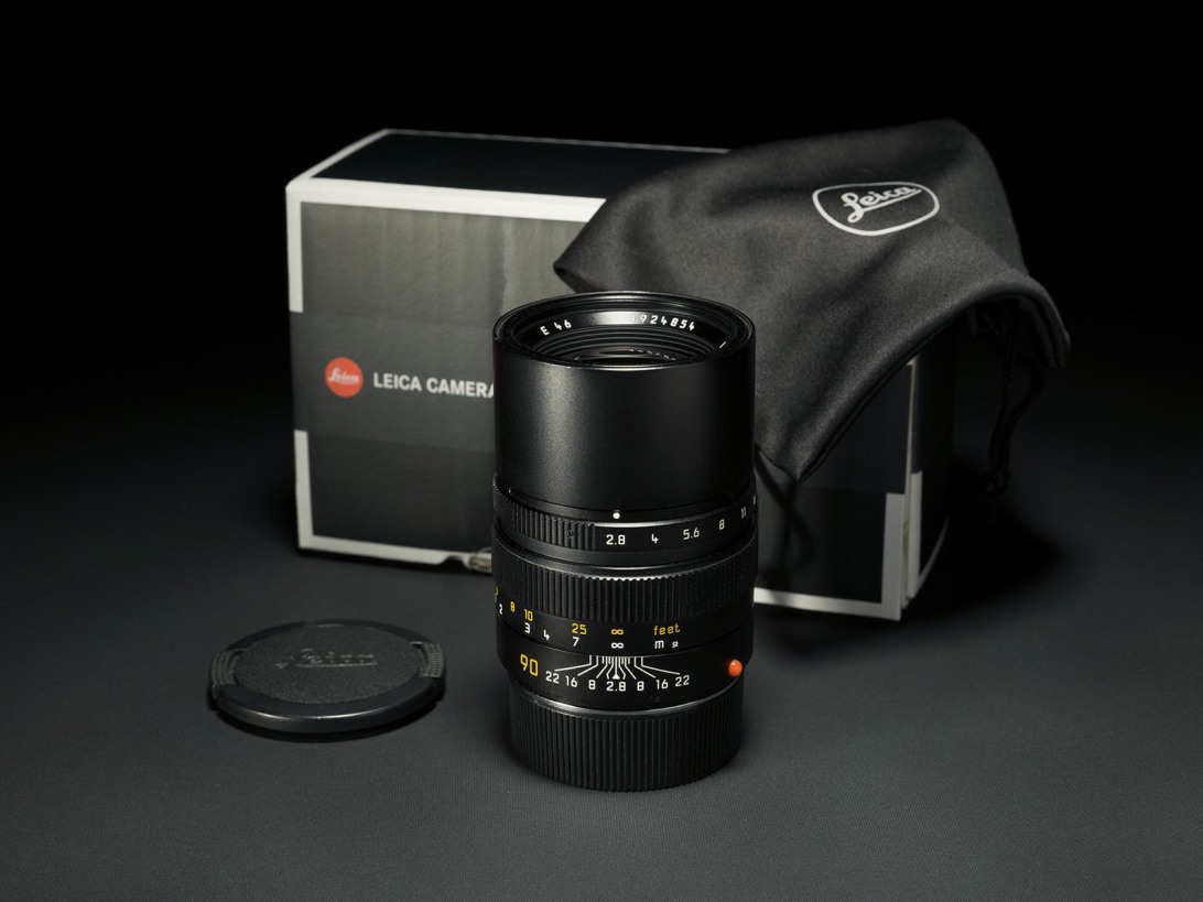

Having owned most of the 90mm lenses made by Leica for the M, my choice is the f/2.8 Elmarit-M (E46) which has a great balance of performance, low flare, handling and cost. That said, I currently also have a f/2.5 Summarit and the two are very close in terms of image quality with the Summarit having marginally greater chroma (dealt with easily enough in pp). I will probably keep the Elmarit-M though.
My observations on the earlier 90s are that they can be softer at full aperture and flare more (especially the 'thin'). None are bad lenses though flare can be frustrating. I liked the Summicrons (the only one I haven't tried is the current one) but prefer the handling on the slower lenses.
One can easily find the f/2.8 Elmarit-M (E46) in mint condition for way less than a grand today. As pgk said above, great balance of performance, low flare, handling and cost. I wouldn't look for something else, or, at least, not  something way more expensive than it.
