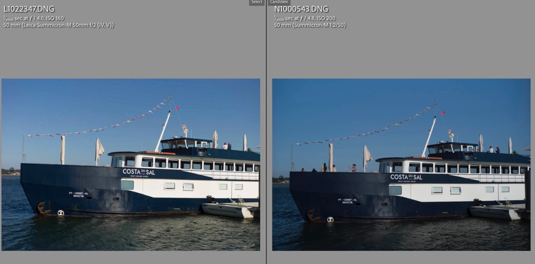

My point is that the M9 would never underexpose like
I’d be very surprised if that were the case, most camera meters will adjust the exposure to a medium (18% grey) exposure and will take a similar underexposed photograph.
I suppose the M9 might’ve had a tighter centre weighted metering, I’m not sure though it’s a long time since I used one in anger.
