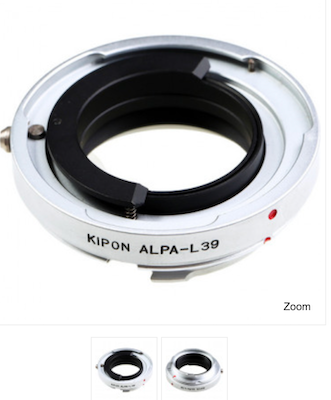

romualdo Posted May 26, 2022 Share #4 Posted May 26, 2022 I have an Alpa 7 with Kern Switar 50mm f1.8 (one of the early apochromatic lenses) I use a Kipon Alpa-L39 adaptor - see Kern Switar with my iiif very veratile combo as I can use this lens on LTM & M cameras Welcome, dear visitor! As registered member you'd see an image here… Simply register for free here – We are always happy to welcome new members! Quote Link to post Share on other sites Simply register for free here – We are always happy to welcome new members! ' data-webShareUrl='https://www.l-camera-forum.com/topic/332803-how-compatible-are-alpa-lenses-%E2%80%A6/?do=findComment&comment=4442323'>More sharing options...

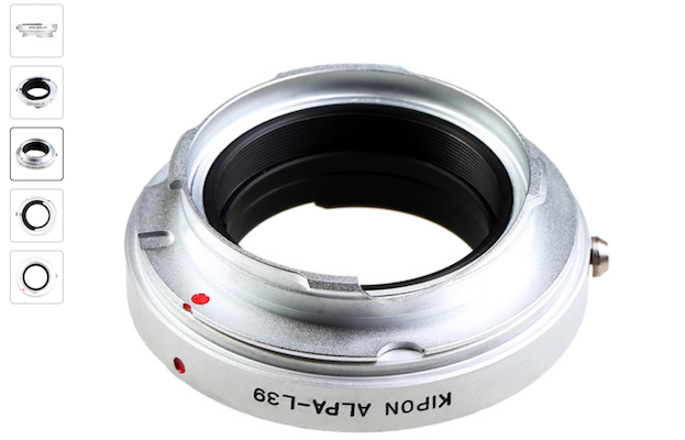

Alberti Posted May 28, 2022 Author Share #8 Posted May 28, 2022 (edited) On 5/26/2022 at 3:37 PM, romualdo said: I have an Alpa 7 with Kern Switar 50mm f1.8 (one of the early apochromatic lenses) I use a Kipon Alpa-L39 adaptor - see Kern Switar with my iiif very veratile combo as I can use this lens on LTM & M cameras Welcome, dear visitor! As registered member you'd see an image here… Simply register for free here – We are always happy to welcome new members! It fits snug. The information about the adapters is scarce, sellers will say 'automated things' such as 'no ROM coupling' but don't know we are the lost generation. So: is this your adapter? [I went ahead and bought it anyway. And I'll be happily surprised if the ring is in the box 😁] And do the internals give RF coupling on the IIIf? (here some fancy art director threw in a LTM to M adapter just to confuse those fuzzy buyers) Edited May 28, 2022 by Alberti Quote Link to post Share on other sites More sharing options...
agfa100 Posted May 29, 2022 Share #9 Posted May 29, 2022 Well I have the Alpa to M mount adp but yes it looks like that one, and it should match up with the rf cam in the L-39 cameras once you remove the L-39 to M adp that this one has on it. Have fun with it when it shows up. Quote Link to post Share on other sites More sharing options...
romualdo Posted May 29, 2022 Share #10 Posted May 29, 2022 (edited) 22 hours ago, Alberti said: It fits snug. The information about the adapters is scarce, sellers will say 'automated things' such as 'no ROM coupling' but don't know we are the lost generation. So: is this your adapter? [I went ahead and bought it anyway. And I'll be happily surprised if the ring is in the box 😁] And do the internals give RF coupling on the IIIf? (here some fancy art director threw in a LTM to M adapter just to confuse those fuzzy buyers) Welcome, dear visitor! As registered member you'd see an image here… Simply register for free here – We are always happy to welcome new members! Yes, that's my adapter but it never came with the LTM to M adapter that you see in the pics - it just has the LTM (screw thread) it does rangefinder couple with all of my LTM cameras - bloody expensive item though IMHO Unfortunately it's the only available version for LTM cameras I presume you saw my contribution (re adjusting the adapter) in a previous thread Edited May 29, 2022 by romualdo Quote Link to post Share on other sites More sharing options...

Alberti Posted June 1, 2022 Author Share #13 Posted June 1, 2022 (edited) This is the adapter I bought. It seems to have the RF coupling cam: the ring on the top is pushed down by the lens, and linearly it is then transferred. I note the movement is not up to Leica standard: I can feel the ridges the CNC machine made when cutting the form of the ring that transfers the focus information. I can't add some oil of course 🤔 and I'm worried it might not be very supple (sticking a bit at times). Anyway, time will tell as I do not have the lens yet. The silver Kipon adapter might be polished. But it is a good start. Welcome, dear visitor! As registered member you'd see an image here… Simply register for free here – We are always happy to welcome new members! So now wait for the grace that my relatives send me their Alpa 🥰 The Switar promises to be such a sweetheart Edited June 1, 2022 by Alberti Quote Link to post Share on other sites Simply register for free here – We are always happy to welcome new members! So now wait for the grace that my relatives send me their Alpa 🥰 The Switar promises to be such a sweetheart ' data-webShareUrl='https://www.l-camera-forum.com/topic/332803-how-compatible-are-alpa-lenses-%E2%80%A6/?do=findComment&comment=4445832'>More sharing options...

agfa100 Posted November 6, 2022 Share #18 Posted November 6, 2022 (edited) If you read this again it's been awhile you have to "adjust" the adp cam to the body I started by setting the adp to stop focusing at inf. mine came with a "key" to do this but you can also use your fingers to move it. Don't write off the Kern macro switar, to me it's the grandfather of the apo summicron if you look at a lens diagram of the kern and compare to a apo summicron you can tell where the apo came from. Also Leitz bought Kern back in the mid to late 80's. It was to get a binocular contract if I remember as the Swiss had a law back then that the military had to buy in country products first for the military and Kern made great binoculars besides lenses and Leitz wanted to bid on the contract so they bought the company to get rid of the competition. And of course they then had all the intellectual property of Kern. Edited November 6, 2022 by agfa100 Quote Link to post Share on other sites More sharing options...
