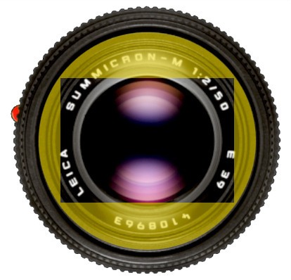

7) A more practical idea might be to mask off the front of your lens's built-in hood to an appropriate-sized rectangle, with black tape or stiffer cardboard (or these days, maybe something 3D-printed in black plastic) - so that it does not vignette the corners, but crops the scene to only and exactly what the sensor/film can see. A "Leica-sized" matte box.
Something like this, where yellow indicates the area masked off. Sliding the hood in and out would allow adjusting (zooming) the crop to exactly the image area.
I tried this with the even-more-flare-prone 90mm Tele-Elmarit-M, by masking off its very long clip-on hood (12575) with black tape.
It did reduce flare, but was also a bit large for carry-around use (with or without the mask) - almost as long as the lens itself. The 50 Summicron's shorter and telescoping hood would be a more - elegant - starting place. ;)
