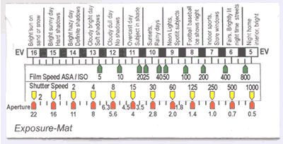

Just as a side note.  Using Sunny 16, the bright sunlight (not snow) is set at an EV of 15 (yes the 16 and 15 can be confusing, 16 is the aperture and 15 is the light level).  Then, shadows by buildings (not alleys) and large canopy, high trees, is typically 2 stops less, or EV 13.  I may meter both when walking about and adjust from there.  So, if I know I’m shooting ISO 125, then in the sunlight I might use 1/1000 sec at f/5.6, and I can pull that back to 1/250 or 1/125 when I hit the shadows.  It’s fast and I will pull out a meter to verify now and then, but can make shooting without a built-in meter more fun / challenging at the same time.
No need battery,
no need app,
no need phone,
just some practices,
Exposure Mat AND practicing a bit for confidence
not metering as such
understanding the process is much better to be free.

5 hours ago, a.noctilux said:
No need battery,
no need app,
no need phone,
I keep a copy in my car, and fully agree with your comments.

19 hours ago, a.noctilux said:
No need battery,
no need app,
no need phone,
100% agree. It takes a little practice but complete freedom from a meter is a liberating way to shoot......every type of scene.

But not a very accurate way of ensuring good exposures. Each to their own though.
I have been shooting film from 7 -8 years now and mostly with no metered Ms, M3, and M2... I now own an MP because I wanted a metered body in case of difficult lighting conditions... In my opinion, film is sooo forgiving that all the work of contrast is done after, I normally got the same results with the MP now in my negatives, than  when I was estimating exposure. I am sure metering is more helpful for slide film where the range  of error is narrower.
Just try one week wihout  a meter, you will feel more confident. The  meter  makes me less confident, and seeing the red dot in the VF distracts me a lot, I wasn't expecting that when I decided to go for a metered M body.
Now my MP runs without batteries.
