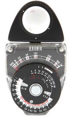

I've ended up back where I started 47 years ago: "The Egg" - a.k.a Sekonic Studio DeLuxe L-28c.
For all my film photography (Hassy SWC, Leica M2, Rolleicord, even my Mamiya 6 (which has a not-very-reliable through-the-viewfinder reflected meter)).
Why?
1) My accessory-shoes are mostly permanently occupied by wide-angle viewfinders.
2) Reflected meters meter the subject (and turn it into medium gray no matter what tone it really was) - incident meters measure the light.
3) No &%$#ing batteries required. Powered by its own photovoltaic selenium sensor.
4) Fits in a pocket, and at 205g, lighter than most M "pocketable" lenses.
Why?
Have been using one of these for the last 50+ years. Initially with various Hasselblads (till the advent of metered Blads) and later with Leica M6's. These days it only gets used with my Leica 111f. Great meter as Adan says, but not so good with the low light levels I inhabit these days.
Why?
The meter I have tried so hard to love. Had the LC-28, 398, 398M and finally a 398A, everyone a great meter. Even had the direct reading slides for most of them. I enjoy using and may even end up with another at some point. Mostly, they get used for a while until I try a different meter. The last one was supplanted by a 308 when  I was using flash and sold it because I felt bad about letting such a nice meter sit.  There are a lot of things to love about the Studio Deluxe and it may call me back for one more try.
