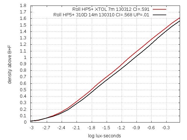

The FX-21 developer gives strong compensation, which tends to offset the curve shape of TMY2, to make it work more like Tri-X or HP5+. See tests:
https://www.photrio.com/forum/threads/t-max-400-has-boomerang-curve.101340/
20130316-tmy2-boomerang-jpg.48305
130312-hp5-214d-xtol-closespeed-jpg.48306
