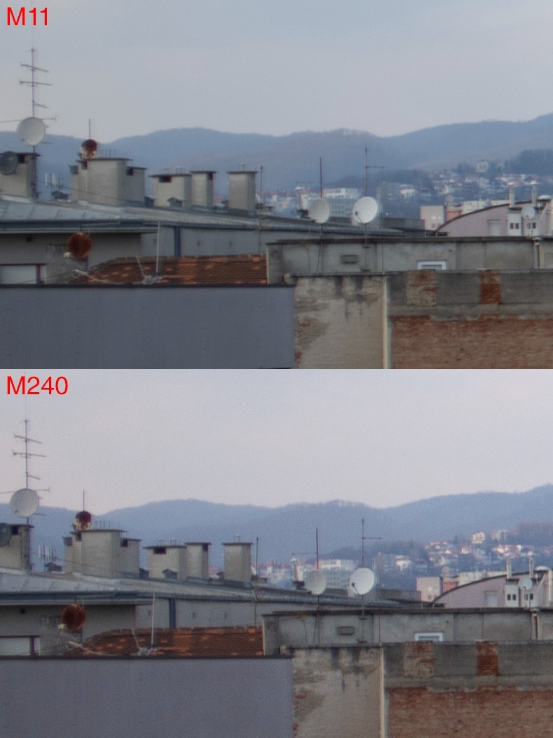

orcinus Posted March 11, 2022 Author Share #32 Posted March 11, 2022 (edited) Okay, here's a quick outdoors test. Some caveats, as before: taking Tailwagger's suggestions in account, i did my best to equalize the brightness and white balance between the photos to exclude the effect on percieved contrast focus is near or at infinity there was some inevitable shift in lighting between the M11 and M240 shots - we've had a lot of wind recently, so clouds move fast, also, i'm working nights and it is still winter, so by the time i'm taking these the sun is already starting to set M11 images have been downsampled to M240 size using the bicubic sharper algorithm images processed using Lightroom, as before noise reduction was set to 0 for luma, and 20 for chroma noise sharpening set to 40 M11 built in profile disabled, all lens corrections disabled (for both) all images are 100% crops I will only include the f/2.0 shots. I've got the "full" range, f/2.0-f/8.0 and can post that well if there's interest. I think it's not necessary as this already brings this to conclusion, at least for focus at infinity and these lighting conditions. I might repeat the test in bright sunlight, pending weather conditions and free time. First, center of frame: Welcome, dear visitor! As registered member you'd see an image here… Simply register for free here – We are always happy to welcome new members! Conclusion: with exposure and white balance equalized, there is little to no difference, as suggested by Tailwagger. Second, edge of frame: Interestingly, here, the M240 has an edge, both in terms of CA and spherical aberation, as well as apparent sharpness. Albeit not a huge edge. Full frame with marked locations of crops, for reference: Edited March 11, 2022 by orcinus 1 Quote Link to post Share on other sites Simply register for free here – We are always happy to welcome new members! Conclusion: with exposure and white balance equalized, there is little to no difference, as suggested by Tailwagger. Second, edge of frame: Interestingly, here, the M240 has an edge, both in terms of CA and spherical aberation, as well as apparent sharpness. Albeit not a huge edge. Full frame with marked locations of crops, for reference: ' data-webShareUrl='https://www.l-camera-forum.com/topic/330539-glow-with-leica-lenses/?do=findComment&comment=4398930'>More sharing options...
lct Posted March 11, 2022 Share #33 Posted March 11, 2022 Interesting thank you. Did you try to upsize the M240 file instead of downsizing the M11's? Just curious. 1 Quote Link to post Share on other sites More sharing options...
adan Posted March 11, 2022 Share #34 Posted March 11, 2022 Sorry - but for me, downsampling a high-res camera's file to match a lower-res camera is like having a race between a tall athlete and a short athlete... ....and cutting the feet off the tall athlete so that both athletes are the same height! "Crippling" the larger file for equality's sake produces meaningless results. The only rational approach is to either show 100% pixels for both (as you already did) - or up-sample the smaller file to the same resolution as the larger file, to show the absolute best each can achieve (which can be sometimes be surprising, especially with Leica's lack of anti-alias filters). 2 Quote Link to post Share on other sites More sharing options...
orcinus Posted March 11, 2022 Author Share #35 Posted March 11, 2022 (edited) 1 hour ago, adan said: Sorry - but for me, downsampling a high-res camera's file to match a lower-res camera is like having a race between a tall athlete and a short athlete... ....and cutting the feet off the tall athlete so that both athletes are the same height! Depends on what is being evaluated. Keep in mind this thread is NOT about the resolution or high frequency detail. This seems to keep getting lost over and over again for some reason. The claim was not that M11 somehow produces less detail, or less lines/mm, or less megapixels. Therefore, what you propose is a meaningless metric - yes, upsampling the M240 file will reveal that M11 has higher resolving power. And? We knew that already, and that has never been contested, has it? In fact, you can see it in the downsampled photos of the resolution chart too. Edited March 11, 2022 by orcinus Quote Link to post Share on other sites More sharing options...
lct Posted March 11, 2022 Share #36 Posted March 11, 2022 22 minutes ago, orcinus said: upsampling the M240 file will reveal that M11 has higher resolving power. And? We knew that already, and that has never been contested, has it? Yes it has, by me. Your M11 pics charts above look blurry at f/2 to me, to the point that i wonder if resolution is not affected. I may be wrong, so much the better then, but so far what your downsized files prove to me is that the M11 is softer than the M240, at least on edges and/or corners, and this is not normal at all. Quote Link to post Share on other sites More sharing options...
