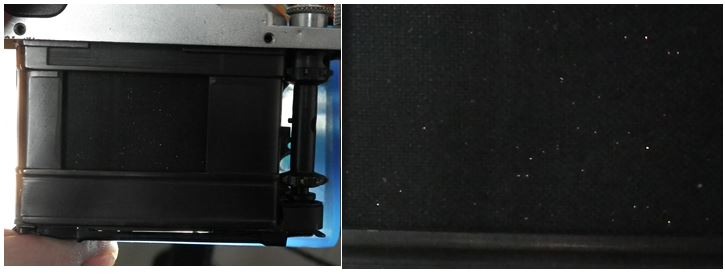

jerzy Posted January 2, 2022 Share #16 Posted January 2, 2022 back to initial topic - many later IIIc and IIIf have problem with curtains which became dry, stiff and they get pinholes. When purchasing IIIf be prepared that as well this camera may suffer it. Of course it may be repaired, similarly like faint rangefinder, see above. Otherwise, if any optical element of rangefinder is broken you will need a donor camera, although some reputable repair persons may have still old/new stock of original spare parts. 1 Quote Link to post Share on other sites More sharing options...
willeica Posted January 2, 2022 Share #17 Posted January 2, 2022 1 hour ago, jerzy said: William, this may be easily fixed. I purchase halfmirrors from Japan, they are multicoated and provide even better contrast than original Leica had at that time. This is for LTM, another story are Ms, where silvered surface is within the cemented prism, this is complicated and costly. Thanks Jerzy. My CLA man here in Dublin bought some of these mirrors. In the case of my late father's Super Baldina, he had to cut the mirror into a tiny piece in order to fit inside the little Balda 1 hour ago, jerzy said: back to initial topic - many later IIIc and IIIf have problem with curtains which became dry, stiff and they get pinholes. When purchasing IIIf be prepared that as well this camera may suffer it. Of course it may be repaired, similarly like faint rangefinder, see above. Small pinholes can be fixed with black Deco Textil material paint or something similar, which is what my CLA guy does sometimes. Jerzy, do you always replace the complete shutter cloth for any pinholes? William Quote Link to post Share on other sites More sharing options...
jerzy Posted January 2, 2022 Share #18 Posted January 2, 2022 vor 5 Minuten schrieb willeica: do you always replace the complete shutter cloth for any pinholes? this depeneds - if the pinhole is result of sun burning a hole through uncovered lens (usually this is a single hole) than one may try to glue it like described. But more often you see something like this - rubber is dry, cracks. Then you have no other choice, even if you cover existing holes with glue in a short time the rubber will fall off in other places. In cases like this I replace always both curtains, even if ther second does not have any hole yet. Welcome, dear visitor! As registered member you'd see an image here… Simply register for free here – We are always happy to welcome new members! 1 Quote Link to post Share on other sites Simply register for free here – We are always happy to welcome new members! ' data-webShareUrl='https://www.l-camera-forum.com/topic/327968-leica-ltm-viewfinder-seviceability/?do=findComment&comment=4343457'>More sharing options...
willeica Posted January 2, 2022 Share #19 Posted January 2, 2022 1 hour ago, jerzy said: this depeneds - if the pinhole is result of sun burning a hole through uncovered lens (usually this is a single hole) than one may try to glue it like described. But more often you see something like this - rubber is dry, cracks. Then you have no other choice, even if you cover existing holes with glue in a short time the rubber will fall off in other places. In cases like this I replace always both curtains, even if ther second does not have any hole yet. Welcome, dear visitor! As registered member you'd see an image here… Simply register for free here – We are always happy to welcome new members! Thanks Jerzy, that is more or less the same as the practice of the CLA guy here in Dublin. The Deco Textil paint coats the small holes and should not wear off under normal use, but if the material is damaged, replacement is the only cure. At least with a Leica you can repair the shutters. My repair man has a Zeiss Ikon Super Nettel camera belonging to me for quite some time as he looks for silk threads to operate the metal blinds. It has put me off going near Contax cameras at all. William 1 Quote Link to post Share on other sites More sharing options...
