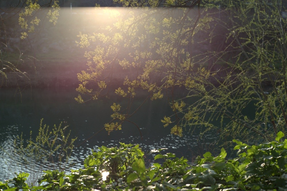

LocalHero1953 Posted December 13, 2021 Share #16 Posted December 13, 2021 I have had something similar in a shot into the sun with a lot of flare. M4 + Summilux-m 35 pre-asph., Tri-X Welcome, dear visitor! As registered member you'd see an image here… Simply register for free here – We are always happy to welcome new members! Quote Link to post Share on other sites Simply register for free here – We are always happy to welcome new members! ' data-webShareUrl='https://www.l-camera-forum.com/topic/327417-any-ideas-what-this-light-leak-or-something-else/?do=findComment&comment=4331487'>More sharing options...
LocalHero1953 Posted December 13, 2021 Share #17 Posted December 13, 2021 But not in just bright light, towards the sun shots with less flare. Welcome, dear visitor! As registered member you'd see an image here… Simply register for free here – We are always happy to welcome new members! Quote Link to post Share on other sites Simply register for free here – We are always happy to welcome new members! ' data-webShareUrl='https://www.l-camera-forum.com/topic/327417-any-ideas-what-this-light-leak-or-something-else/?do=findComment&comment=4331488'>More sharing options...
LocalHero1953 Posted December 13, 2021 Share #18 Posted December 13, 2021 As it wasn't a pervasive problem, I filed it under 'Interesting' and 'To look at sometime'. I agree, it is obviously not a light leak. Like the OP it is at the top of the image, and the bottom of the frame in the camera. I reckoned the flare was actually a reflection off some other part of the lens or body, and the strip was a shadow from part of the frame. I haven't yet looked inside the camera to see if that is plausible. Quote Link to post Share on other sites More sharing options...
a.noctilux Posted December 13, 2021 Share #19 Posted December 13, 2021 Adan explained this type of flare very well https://www.l-camera-forum.com/topic/315481-problem-with-refraction-of-light/?do=findComment&comment=4086698 in this thread I had this on M-D also Welcome, dear visitor! As registered member you'd see an image here… Simply register for free here – We are always happy to welcome new members! 2 Quote Link to post Share on other sites Simply register for free here – We are always happy to welcome new members! ' data-webShareUrl='https://www.l-camera-forum.com/topic/327417-any-ideas-what-this-light-leak-or-something-else/?do=findComment&comment=4331537'>More sharing options...
