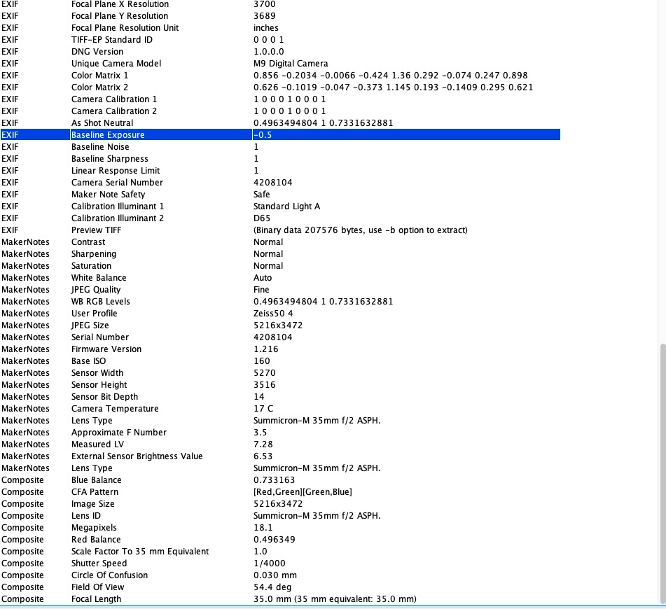

S Maclean Posted January 25, 2023 Share #245 Posted January 25, 2023 1 hour ago, Adam Bonn said: it's not as simple as that, even if the effect is only visible in the SOOC jpeg then it comes from a RAW setting because the camera makes jpegs from it's own RAW, there's a ton of stuff in the RAW file that the RAW app can chose to act upon (or not) - for example, ever use an M9? Ever open an M9 DNG in an Adobe product? Well you just applied a -0.5 EV drop purely because Leica put a tag in the M9 DNG that says drop shot exposure by 0.5EV Remember how on the M9/240 adobe always has zero NR, then after the M10 it started adding different values based on ISO? That's because there's stuff in the RAW file telling it to do it 🙄 I don't know enough about C1 to know how it interprets DNG data... AFAIK C1 M lens profiles don't do anything anyway (certainly never corrected the distortion that my 35 'rit had) I am not sure that information is in the raw file...it's on the camera or lens profile. Now, logically the camera model and lens info is contained in the RAW file, but the file itself just carries the information, not the changes. That's why, when there are programs (DXO, C1, LR) that are not updated on the profile of a lens or camera it won't do anything with that data, just ignore it. In other words; The Raw file is RAW until converted by a program or a camera (into JPG). The RAW file tells the program "Hey, I come from an M9, and the program says...."That means I will take -0.5 EV as per the specifications on that profile" Change the camera model or lens model on the EXIF data and a different outcome will take place. Quote Link to post Share on other sites More sharing options...

Adam Bonn Posted January 25, 2023 Share #247 Posted January 25, 2023 Advertisement (gone after registration) 19 minutes ago, S Maclean said: I am not sure that information is in the raw file...it's on the camera or lens profile. Now, logically the camera model and lens info is contained in the RAW file, but the file itself just carries the information, not the changes. That's why, when there are programs (DXO, C1, LR) that are not updated on the profile of a lens or camera it won't do anything with that data, just ignore it. In other words; The Raw file is RAW until converted by a program or a camera (into JPG). The RAW file tells the program "Hey, I come from an M9, and the program says...."That means I will take -0.5 EV as per the specifications on that profile" Change the camera model or lens model on the EXIF data and a different outcome will take place. well it is! Quote Adobe has updated its DNG digital negative specification to allow a series of image corrections to be embedded in the file. Version 1.3 of the non-proprietary RAW file format allows a series of 'corrections and enhancements', which Adobe is calling opcodes, to be defined in DNG files. These opcodes include the ability to specify corrections for lens aberrations such as geometric distortion and lateral chromatic aberration that should be made to the RAW data when it's processed. Adobe has this to say about opcodes: "DNG 1.3 now includes opcodes, a defined list of operations and their parameters for performing complex activities in the raw file conversion process. These activities include corrections and enhancements that are beneficial when performed prior to the demosaic process but are difficult due to a camera's limited processing power. They also include corrections and enhancements that can only be performed after the demosaic process such as lens correction. By utilizing opcodes, photographers can maintain the advantages of raw mosaic data, giving them increased opportunity to improve their photographs with the maximum amount of image data preserved. The DNG SDK has also been updated to reflect the changes to the specification." from here Also here's a screen shot showing some of the tags in an M9 file (there's tags in all the Leica DNGs) - I've highlighted the baseline exposure offset Welcome, dear visitor! As registered member you'd see an image here… Simply register for free here – We are always happy to welcome new members! These are all instructions written by Leica for the RAW app to act upon (and let's be honest DNG is adobe's invention, Leica's choice to use and back in the day Leica used to give you a free copy of LR with their cameras - so it's a safe bet that Leica expect's adobe solution to be the RAW app product that's used) Now how much of this info adobe choses to act on, whether they act on it the same way with CC as they did with LR3 (or whatever it was back when the M9 came out) I couldn't tell you... But I assure you a RAW file is not some vanilla entity that starts life in your RAW app for you to shape like clay.... it arrives in your RAW app full of suggestions from the OEM, that your RAW app may/may not act upon and that you can undo/not undo and all this happens with very little visibility... as a general rule of thumb the maker notes are suggestions and/or 'FYI' but anything tagged as EXIF is instrumental to the imaging pipeline of the RAW file, from obvious stuff like what camera was it, to the AsShotNeutral tag which means the white balance was this the ColorMatrix tags are the embedded Leica profile and well that's enough, I get carried away talking about this stuff and I'm waaaay off topic (again)! 2 Quote Link to post Share on other sites Simply register for free here – We are always happy to welcome new members! These are all instructions written by Leica for the RAW app to act upon (and let's be honest DNG is adobe's invention, Leica's choice to use and back in the day Leica used to give you a free copy of LR with their cameras - so it's a safe bet that Leica expect's adobe solution to be the RAW app product that's used) Now how much of this info adobe choses to act on, whether they act on it the same way with CC as they did with LR3 (or whatever it was back when the M9 came out) I couldn't tell you... But I assure you a RAW file is not some vanilla entity that starts life in your RAW app for you to shape like clay.... it arrives in your RAW app full of suggestions from the OEM, that your RAW app may/may not act upon and that you can undo/not undo and all this happens with very little visibility... as a general rule of thumb the maker notes are suggestions and/or 'FYI' but anything tagged as EXIF is instrumental to the imaging pipeline of the RAW file, from obvious stuff like what camera was it, to the AsShotNeutral tag which means the white balance was this the ColorMatrix tags are the embedded Leica profile and well that's enough, I get carried away talking about this stuff and I'm waaaay off topic (again)! ' data-webShareUrl='https://www.l-camera-forum.com/topic/327343-voigtlander-50mm-f1-vm/?do=findComment&comment=4658141'>More sharing options...

S Maclean Posted January 25, 2023 Share #249 Posted January 25, 2023 20 minutes ago, Adam Bonn said: well it is! from here Also here's a screen shot showing some of the tags in an M9 file (there's tags in all the Leica DNGs) - I've highlighted the baseline exposure offset Welcome, dear visitor! As registered member you'd see an image here… Simply register for free here – We are always happy to welcome new members! These are all instructions written by Leica for the RAW app to act upon (and let's be honest DNG is adobe's invention, Leica's choice to use and back in the day Leica used to give you a free copy of LR with their cameras - so it's a safe bet that Leica expect's adobe solution to be the RAW app product that's used) Now how much of this info adobe choses to act on, whether they act on it the same way with CC as they did with LR3 (or whatever it was back when the M9 came out) I couldn't tell you... But I assure you a RAW file is not some vanilla entity that starts life in your RAW app for you to shape like clay.... it arrives in your RAW app full of suggestions from the OEM, that your RAW app may/may not act upon and that you can undo/not undo and all this happens with very little visibility... as a general rule of thumb the maker notes are suggestions and/or 'FYI' but anything tagged as EXIF is instrumental to the imaging pipeline of the RAW file, from obvious stuff like what camera was it, to the AsShotNeutral tag which means the white balance was this the ColorMatrix tags are the embedded Leica profile and well that's enough, I get carried away talking about this stuff and I'm waaaay off topic (again)! Interesting. Thank you! 1 Quote Link to post Share on other sites More sharing options...

hdmesa Posted January 25, 2023 Share #255 Posted January 25, 2023 (edited) 7 hours ago, Adam Bonn said: I thought it influenced the raw as well? Well today I must not have fully attached my 50 lux as it took me 3 shots to notice the frame lines were wrong and the info screen said 21mm/2.8 so I can see if there's any difference in the DNGs when I get home The lens correction and vignetting are not baked to the DNG file on the M cameras (not sure if it writes it to the DNG or not, but LR/C1 do not apply it by default). On the SL cameras for some reason, vignette correction is baked into the DNG if you selected an M lens profile in-camera, and the correction cannot be removed in LR/C1 (data is likely not written into the DNG but is part of the DNG processing in camera). If it were merely a correction flagged as mandatory, we would still be able to turn off the correction in C1. Edited January 25, 2023 by hdmesa 2 Quote Link to post Share on other sites More sharing options...
Adam Bonn Posted January 25, 2023 Share #256 Posted January 25, 2023 13 minutes ago, hdmesa said: The lens correction and vignetting are not baked to the DNG file on the M cameras (not sure if it writes it to the DNG or not, but LR/C1 do not apply it by default). On the SL cameras for some reason, vignette correction is baked into the DNG if you selected an M lens profile in-camera, and the correction cannot be removed in LR/C1 (data is likely not written into the DNG but is part of the DNG processing in camera). If it were merely a correction flagged as mandatory, we would still be able to turn off the correction in C1. That’s fantastic info, thank you 2 Quote Link to post Share on other sites More sharing options...
