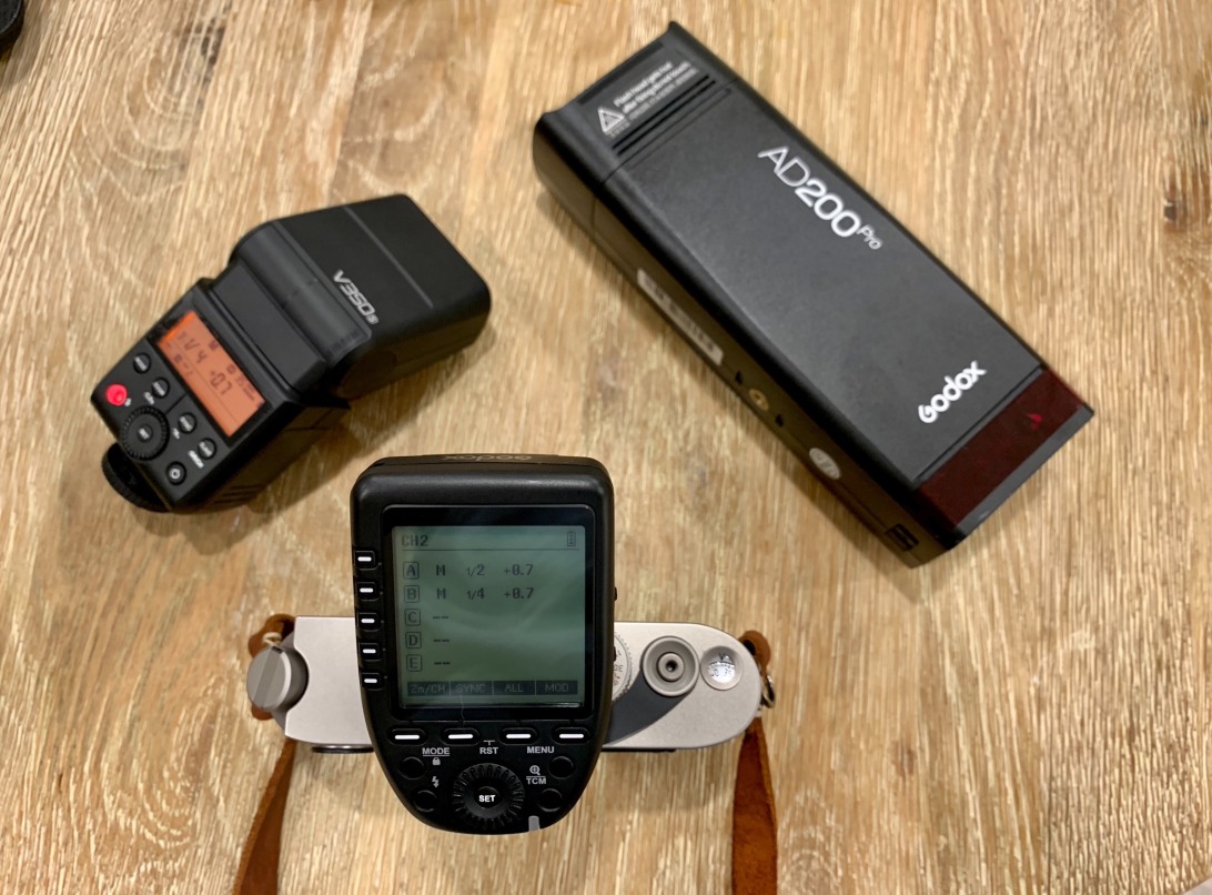

Steven Posted December 3, 2021 Share #49 Posted December 3, 2021 4 hours ago, grahamc said: Hey Steven If you want to use flash without the cable, you can use a wifi (or maybe it's bluetooth) 'trigger' which communicates with the flash and fires it when you press the shutter . Such as these ones I have from Godox. The one on the left a super light flash . I use these two for a very simple off-camera 2 light set up. It's just to show you how a cable-less version works really (You can see on the photo of the Trigger that 2 channels A and B are set, which will fire both of these lights together). Having a trigger on each of 2 cameras during the same shoot (eg Digital and Film) would fire the flash when the Shutter of either camera is pressed, if at all useful to save changing things. Unfortunately with Godox, they don't make a Leica version of the trigger (the 'foot' that inserts into the hotshoe is brand-specific). I use a Canon trigger which fits the Leica hotshoe and fires the flash, however won't send TTL information. I presume there's Leica equipment to do so or other brands that support Leica TTL but I don't know because I bought all this when I shot another system. The trigger looks massive here btw but it's not, and there are ones with smaller LCDS/more compact all round. Could be a cool cable-less option if there is something out there that supports Leica intelligence . TTL would then work when shooting your M10R for example. Welcome, dear visitor! As registered member you'd see an image here… Simply register for free here – We are always happy to welcome new members! Th Thank you so much for writing this up, this is very useful 😁 Quote Link to post Share on other sites More sharing options...
