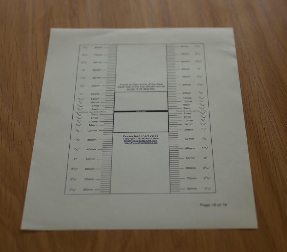

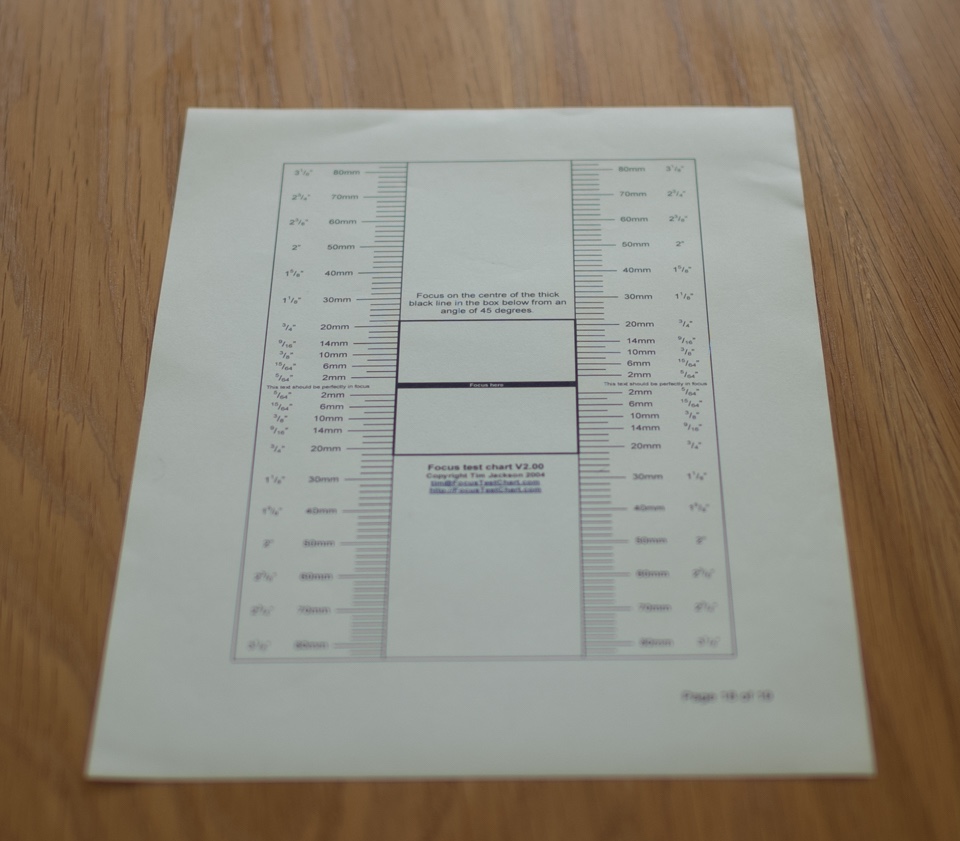

dkmoore Posted November 27, 2021 Author Share #22 Posted November 27, 2021 13 hours ago, IkarusJohn said: Okay, so I set up my M10-D on a tripod, angled at about 45º pretty much at minimum focusing distance, f/1.4. First with OVF Welcome, dear visitor! As registered member you'd see an image here… Simply register for free here – We are always happy to welcome new members! Then with EVF What size paper is the test chart printed on? glad your copy is good! 1 Quote Link to post Share on other sites More sharing options...

tobey bilek Posted November 27, 2021 Share #25 Posted November 27, 2021 Value of sir camera comes through. All my lenses, fast and slow, 50mm & up, focus perfectly On m8, M10, M10R. M9 sensor bit the dust. Quote Link to post Share on other sites More sharing options...

tightsqueez Posted November 28, 2021 Share #27 Posted November 28, 2021 Advertisement (gone after registration) On 11/26/2021 at 6:01 PM, IkarusJohn said: Okay, so I set up my M10-D on a tripod, angled at about 45º pretty much at minimum focusing distance, f/1.4. First with OVF Welcome, dear visitor! As registered member you'd see an image here… Simply register for free here – We are always happy to welcome new members! Then with EVF Even with these low rez images I can tell these are considerably off. The OVF is front focusing quite a bit. What's funny is that 99% of users would never know that it existed because in real life external factors (e.g. subject movement) impact focus more. If you look for problems, guess what... you'll find them. 2 Quote Link to post Share on other sites More sharing options...
IkarusJohn Posted November 28, 2021 Share #28 Posted November 28, 2021 1 minute ago, tightsqueez said: Even with these low rez images I can tell these are considerably off. The OVF is front focusing quite a bit. What's funny is that 99% of users would never know that it existed because in real life external factors (e.g. subject movement) impact focus more. If you look for problems, guess what... you'll find them. True … if you look … 1 Quote Link to post Share on other sites More sharing options...
