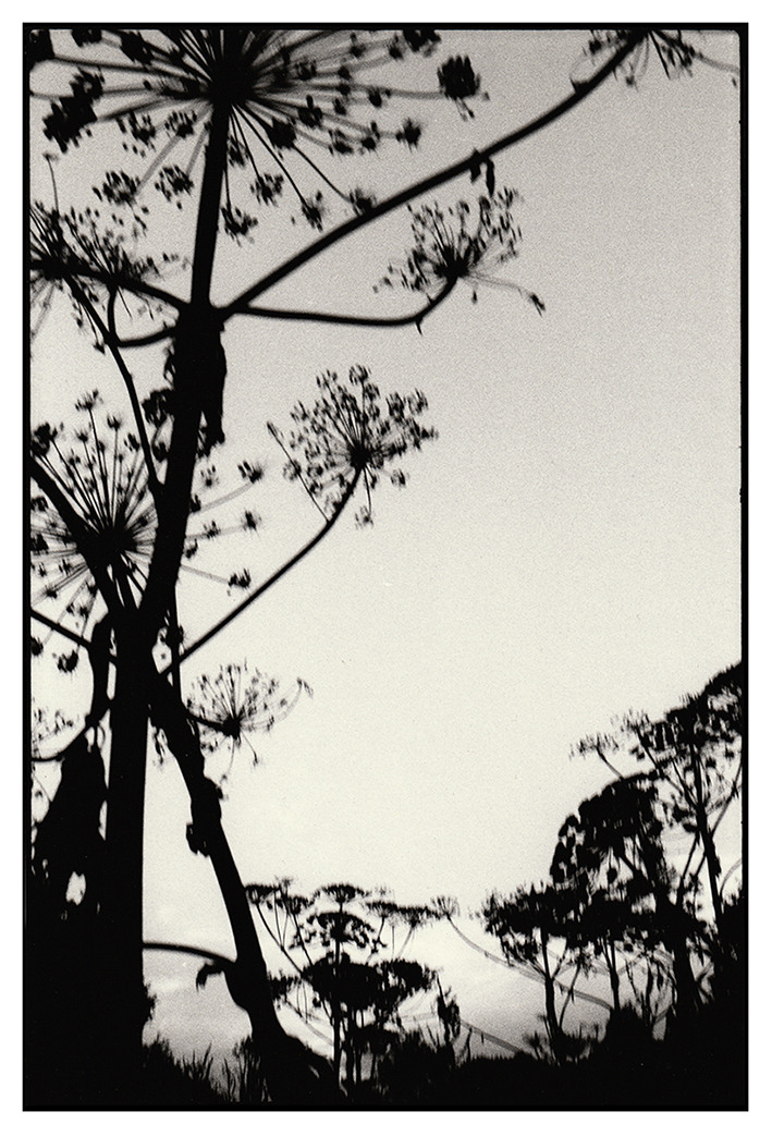

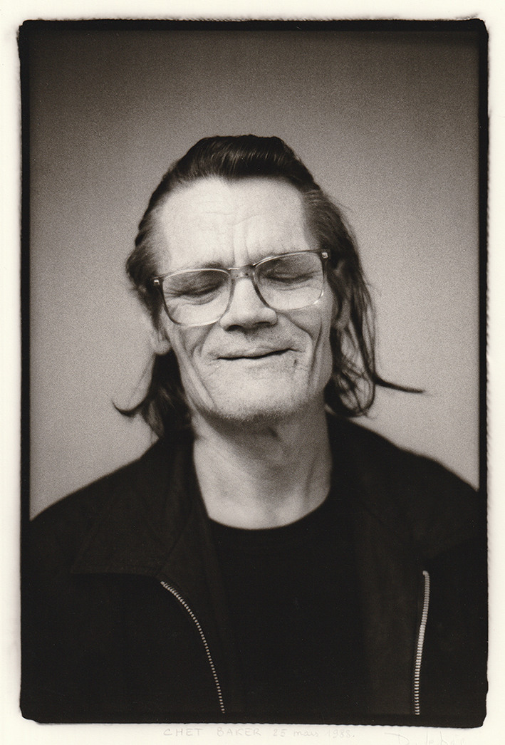

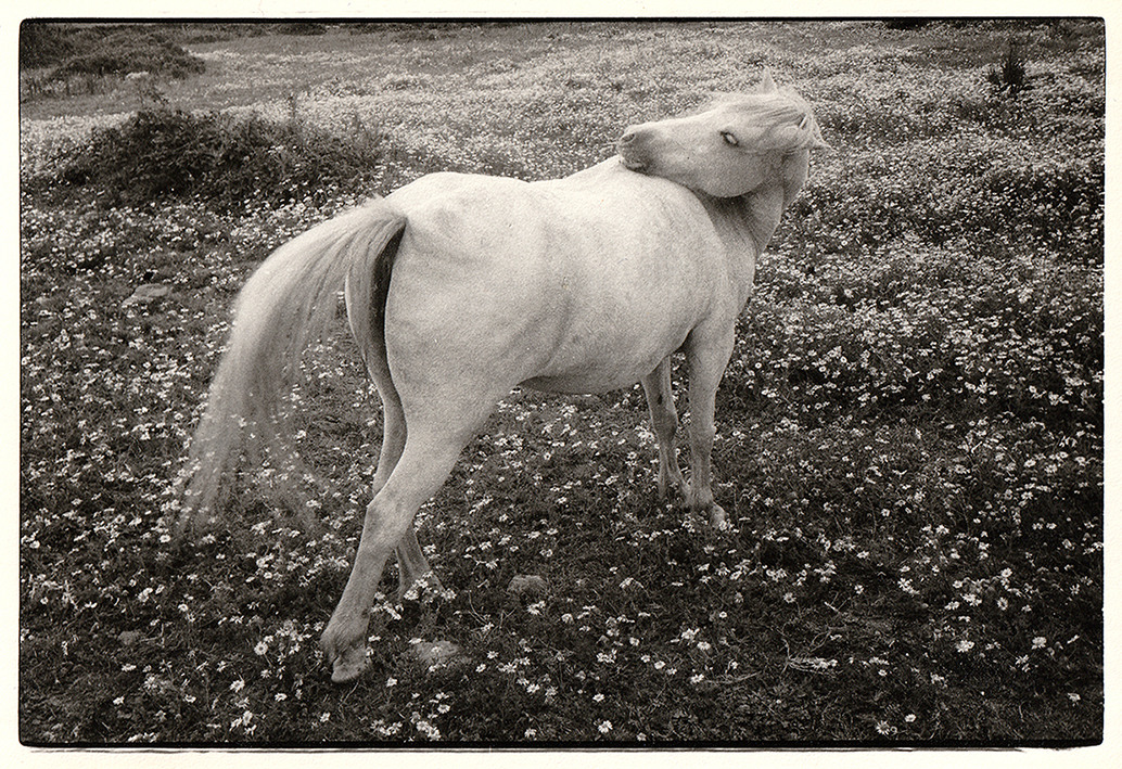

Here some examples with different ways to include the negative borders.
The horse and the portrait of Chet Baker are by two friends, the Hogweed is mine
the horse: typical border from the negative mask of the Leitz Focomat Ic and Valoy II. Between different masks there is never an identical border. This is also due to negatives from different cameras hardly ever being identical
The portrait of Chet Baker: the borders were probably masked by the enlarger, I think a 6x6 Durst
The Hogweed: printed with a Leitz Focomat Ic and a filed out negative mask, then masked with the blades of the easel
Edited by M.Hilo
19 hours ago, M.Hilo said:
Aryel,
Really great examples. Thanks a lot for sharing these. It really works for these images and contribute to draw the eyes on the subjects. I really like it on the last one, where it blends perfectly within the photo.
Seeing the real prints must be even better.
Thanks again for sharing 😊
edit: forgot to say that the horse and the portrait are both fantastic !
Edited by Aryel
