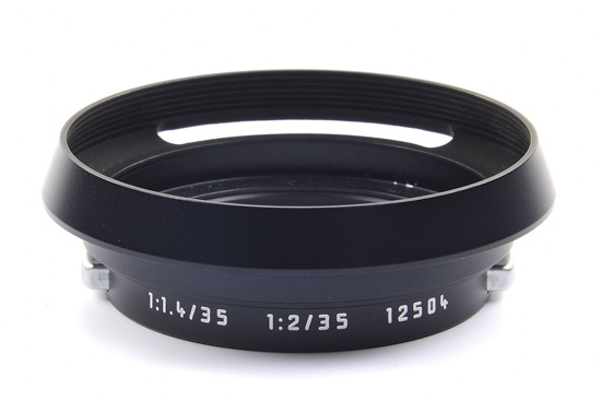

lct Posted November 2, 2021 Share #4 Posted November 2, 2021 Sure you can use a metal hood on the Elmarit 28/2.8 asph v1 (11666), the superb 12504 below. It is less efficient than plastic 12524 & 12526 hoods but can be found in silver and "Hammertone" variants (below) with a bit of luck. Welcome, dear visitor! As registered member you'd see an image here… Simply register for free here – We are always happy to welcome new members! 1 Quote Link to post Share on other sites Simply register for free here – We are always happy to welcome new members! ' data-webShareUrl='https://www.l-camera-forum.com/topic/325991-elmarit-28mm-hood/?do=findComment&comment=4304958'>More sharing options...

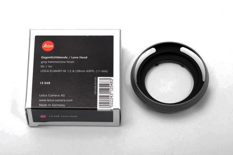

lct Posted November 2, 2021 Share #8 Posted November 2, 2021 The hammertone finish hood (12548) was made for the Elmarit 28/2.8 asph v1: Welcome, dear visitor! As registered member you'd see an image here… Simply register for free here – We are always happy to welcome new members! Quote Link to post Share on other sites Simply register for free here – We are always happy to welcome new members! ' data-webShareUrl='https://www.l-camera-forum.com/topic/325991-elmarit-28mm-hood/?do=findComment&comment=4305203'>More sharing options...
