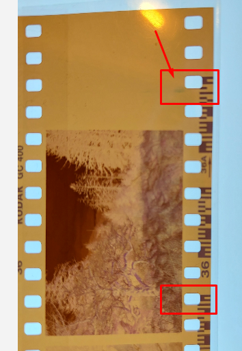

Hi,
I’m having some long time light leak issues with my MP. I noticed it about a year ago (bought it new in January 2020), until then, I didn’t have any issues at all. First, I thought it was a faulty film canister, but I tried fresh film from different brands and manufacturers, and I was having the same issue so, as the camera was in warranty, I decided to send it to Wetzlar.
3 months after, I received the camera and, after a couple of test rolls, I was having the same issue, so I thought it might be my process, as I develop my film at home, and I was assuming that Leica is a serious company and they did their job. Last April, I shot a roll of film colour, sent it to the lab and there were no issues at all.
I had a darkroom hiatus during the Summer and last weekend I developed three rolls: two of them shot with the MP and one with the M4-P. I used a different tank as I used to, a new changing bag and fresh chemicals, just in case, and I had the same issue in one of the rolls I shot with the MP (the other one was shot at night). The roll shot with the M4-P came out perfectly exposed and clean of light leaks, so I can discard my developing process.
I see that some leaks follow a pattern and sometimes the sprockets also generate some patterns, so maybe it happens in the take-up spool area?
Has anyone experienced something like this? It’s driving me crazy and I’m thinking about sending it again to Wetzlar before the warranty expires, but that would mean another three months of repair service and not knowing where the issue comes from.
I’ve attached some images of my negatives. The positives are shot before sending the camera to Wetzlar. The negatives are form the last roll I developed yesterday.
Many thanks in advance.
I've seen some light leaks, and I've seen some light leaks, but that is an aggressive light leak that I've never seen before.
Its coming from above (image projected by the lens is upside down and back to front). It's so radical the first question would be 'is the rear door closed properly before the baseplate has been attached ( a body half case could mask other light leaks in this situation)'? Alternatively have you looked to see if there is any torn film stuck in the camera?

Do you use a case? Please tape the rear door with black tape. The sample 11+11a is different, the others are alike.
I don't use a case, but I'll shoot a test roll with the rear door taped. Thank you!

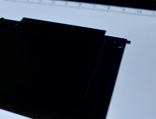

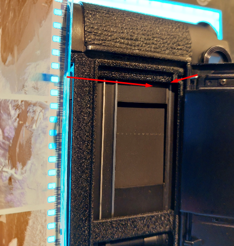

Ok, so yesterday I developed the test roll and I got some interesting results.
The way I shot the entire roll was: 10 frames without tape, another 5 with the rear door fully taped, 5 more with the left and right sides taped, 5 more with the top and the bottom sides of the rear door taped and another 10 without tape again. All of the shots were shot with the 50mm summicron with the lens cap on under direct sunlight at my balcony. In order to separate the different parts of the roll where I taped/untaped the rear door, I shot a frame without the lens cap on, overexposing the shot on purpose.
It turns out that there are no light leaks when the camera was shot with the lens cap on, so the leak is appearing then the shutter is fired. The leak affects partially the exposed frame, but it especially affects the previous frame. It's like something on the inside reflects light and creates leaks.
Here's a sample:
That's very odd! If it's leaking that badly I'm surprised you got any results at all previously.
What do you see if you look at the shutter curtains from the back and shine a bright light into the lens mount? I have heard of leaks due to slack in the shutter curtains but this appears to be excessive.
Just took a look at it and I didn't see anything weird. It looks normal to me and I see no light leaking from the curtains.

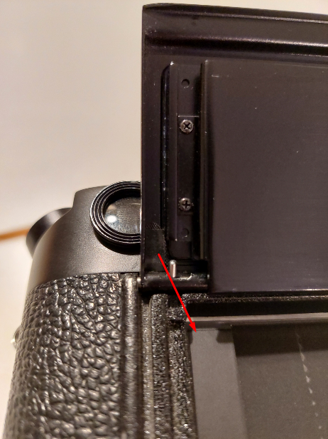

I'm not sure I understand the testing procedure of shooting with the lens cap on, but it's the repeating defined pattern between 19 and 19A and 20 and 20A that still has my attention, it looks like something hard edged is broken. It appears to be there in every circumstance except your night time shot. Have you checked the strap lug on the film advance /shutter button side of the camera, has it maybe pulled loose? That would perhaps explain the direction of the light seeming to come from above (film upside down in the camera etc.) and spreading down over the film.  And a longer shot, have you checked the tripod bush in the baseplate, has it been attached to a tripod or accessory that has a screw that's too long and it's popped the bush open when tightened?

My intention with shooting with the lens cap on was to reduce the 'visual noise' of having a picture in the frame. In that way, I could identify the exact shape of the leak. Thanks to that, I've discovered that it only appears when the light comes through the lens, and not from the rear part of the body.
The frustrating thing is that I've checked everything carefully: baseplate, strap lug, etc. Even I've fired the shutter with the rear door open in front of a flashlight and I haven't seen anything weird. My only guess about the leak's pattern is that maybe it's caused by reflected light on a metallic piece, maybe the cog for the film sprockets?

Well done. Could it be the lens? I think no, but there are minor leaks at 20-20a. The mount?
