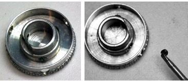

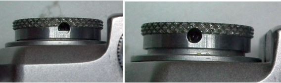

jerzy Posted June 26, 2021 Share #6 Posted June 26, 2021 Ben, drawing and my comment about flash does not apply to your camera (black dial), speed dial is constructed differently, it looks like below Welcome, dear visitor! As registered member you'd see an image here… Simply register for free here – We are always happy to welcome new members! there are 3 screws hidden inside. Screws are very short, you may see one on the tip of screwdriver. On this occasion - if you have tone then use magnetized screwdriver (1-1,5mm). You will need to losen the screw salign and the screw will hold on screwdriver if loosen too much. Otherwise it may fall between the flash contact below and possibly damage it when winding. Left photo shows the position of speed dial on all settings except 1/1000. The hole is partially covered by the guard behind but at 1/1000 (right) you may easily access the screws 1 Quote Link to post Share on other sites Simply register for free here – We are always happy to welcome new members! there are 3 screws hidden inside. Screws are very short, you may see one on the tip of screwdriver. On this occasion - if you have tone then use magnetized screwdriver (1-1,5mm). You will need to losen the screw salign and the screw will hold on screwdriver if loosen too much. Otherwise it may fall between the flash contact below and possibly damage it when winding. Left photo shows the position of speed dial on all settings except 1/1000. The hole is partially covered by the guard behind but at 1/1000 (right) you may easily access the screws ' data-webShareUrl='https://www.l-camera-forum.com/topic/322062-misaligned-exposure-dial-on-a-iiif/?do=findComment&comment=4226435'>More sharing options...

Spunto the Rat Boy Posted June 26, 2021 Author Share #8 Posted June 26, 2021 3 hours ago, jerzy said: Ben, drawing and my comment about flash does not apply to your camera (black dial), speed dial is constructed differently, it looks like below Welcome, dear visitor! As registered member you'd see an image here… Simply register for free here – We are always happy to welcome new members! there are 3 screws hidden inside. Screws are very short, you may see one on the tip of screwdriver. On this occasion - if you have tone then use magnetized screwdriver (1-1,5mm). You will need to losen the screw salign and the screw will hold on screwdriver if loosen too much. Otherwise it may fall between the flash contact below and possibly damage it when winding. Left photo shows the position of speed dial on all settings except 1/1000. The hole is partially covered by the guard behind but at 1/1000 (right) you may easily access the screws Jerzy, Once again, thank you very much for a thorough and informative answer. They're just fascinating machines, aren't they? I suspect the chances of my doing damage if I try this are much greater than the small annoyance from the misalignment itself, so I'm going to leave it alone, I think. Thanks again, Ben Quote Link to post Share on other sites More sharing options...
