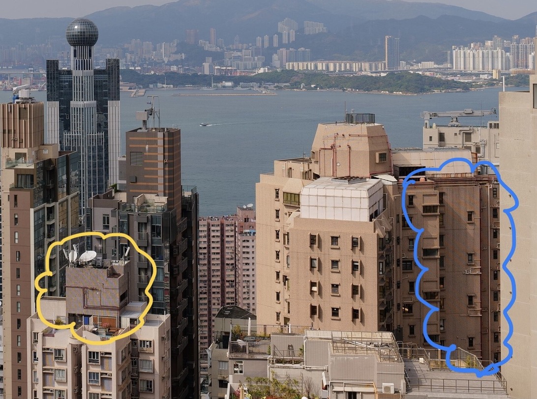

Chun Wah LAM Posted February 28, 2021 Share #14 Posted February 28, 2021 Being an amateur, can someone enlighten me what’s wrong with the colour at circled areas. Shot with SL2-S + APO SL 35mm f4.5, 1/1000 sec, AWB, ISO 100. Thanks. Welcome, dear visitor! As registered member you'd see an image here… Simply register for free here – We are always happy to welcome new members! Quote Link to post Share on other sites Simply register for free here – We are always happy to welcome new members! ' data-webShareUrl='https://www.l-camera-forum.com/topic/318369-cromatic-aberration/?do=findComment&comment=4150323'>More sharing options...
Patrickxyz Posted February 28, 2021 Share #15 Posted February 28, 2021 vor 3 Minuten schrieb Chun Wah LAM: Being an amateur, can someone enlighten me what’s wrong with the colour at circled areas. Shot with SL2-S + APO SL 35mm f4.5, 1/1000 sec, AWB, ISO 100. Thanks. Welcome, dear visitor! As registered member you'd see an image here… Simply register for free here – We are always happy to welcome new members! Looks like moire to me. Quote Link to post Share on other sites More sharing options...
Chun Wah LAM Posted February 28, 2021 Share #16 Posted February 28, 2021 Thank you. I thought APO is invincible. Quote Link to post Share on other sites More sharing options...
farnz Posted February 28, 2021 Share #17 Posted February 28, 2021 30 minutes ago, Chun Wah LAM said: Thank you. I thought APO is invincible. Moiré's not caused by a failing in your lens, it's caused by the absence of an Anti-Aliasing (AA) filter that's absent because Leica's aim is to maximise resolution so it's a trade-off. Either don't add an AA filter over the sensor and capture maximum detail with occasional Moiré or add an AA filter to never get Moiré and sacrifice detail in every picture taken. Aliasing occurs when there are tight, repeating patterns in the object, the sensor's resolution is similar to the pitch of the pattern and the sensor can't quite decide whether the pixel (sensel) should be red or green and it figuratively flips a coin. As the pattern in the object repeats the coin flipping does too the red/green Moiré pattern results. Moiré's easily fixed in most raw conversion software. Pete. 3 2 Quote Link to post Share on other sites More sharing options...
LD_50 Posted February 28, 2021 Share #18 Posted February 28, 2021 1 hour ago, farnz said: Moiré's not caused by a failing in your lens, it's caused by the absence of an Anti-Aliasing (AA) filter that's absent because Leica's aim is to maximise resolution so it's a trade-off. Either don't add an AA filter over the sensor and capture maximum detail with occasional Moiré or add an AA filter to never get Moiré and sacrifice detail in every picture taken. Aliasing occurs when there are tight, repeating patterns in the object, the sensor's resolution is similar to the pitch of the pattern and the sensor can't quite decide whether the pixel (sensel) should be red or green and it figuratively flips a coin. As the pattern in the object repeats the coin flipping does too the red/green Moiré pattern results. Moiré's easily fixed in most raw conversion software. Pete. Moire is also eliminated as resolution increases. An SL2 may not exhibit moire in the same photo. 1 Quote Link to post Share on other sites More sharing options...
beewee Posted February 28, 2021 Share #19 Posted February 28, 2021 (edited) 3 hours ago, Chun Wah LAM said: Thank you. I thought APO is invincible. Actually, if you have a less sharp lens, it would “fix” the problem 🤣 The problem is that your lens out resolves the sensor and there is high frequency content in the image that is higher than what the sensor can capture so you get moire which is a photographic term for aliasing. An anti-aliasing filter is what is normally put in front of the sensor to prevent such problem but that basically just blurs the image before it hits the sensor. Lightroom does have the ability to get rid of moire. Edited February 28, 2021 by beewee Quote Link to post Share on other sites More sharing options...
