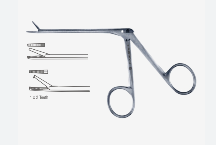

romualdo Posted February 18, 2021 Share #21 Posted February 18, 2021 (edited) Advertisement (gone after registration) 5 hours ago, wlaidlaw said: Getting tiny shreds of film out of Barnack cameras without disassembly can be a nightmare. A few years ago, I bought a pair of crocodile nose forceps https://www.medisave.co.uk/instrapac-hartman-crocodile-forceps-22cm.html?gclid=CjwKCAiAmrOBBhA0EiwArn3mfPEOadm8ramdrAjRv_dOX0p86hIie8UD-Ykz0arkhTb99l3D_3jpQRoCIvIQAvD_BwE which can get into the parts of the camera bodies that nothing else will reach. As they have a very smooth and rounded profile, as long as you are careful and very gentle, the risk of damage is low. Wilson Ha!! an essential piece of equipment in the Veterinary world !! I've used those forceps many times Edited February 18, 2021 by romualdo Quote Link to post Share on other sites More sharing options...

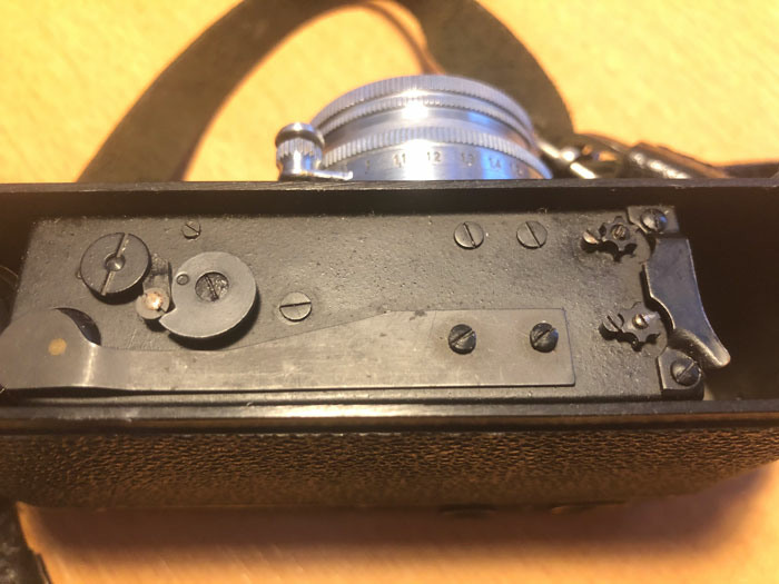

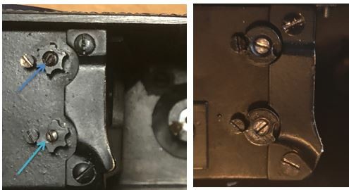

jerzy Posted February 18, 2021 Share #22 Posted February 18, 2021 Am 15.2.2021 um 12:54 schrieb philipus: after 4-5 exposures the film advance action would become very "tough" is the problem solved? If not, on base on above sentence I would suspect rewind knob. When loaded film is usually loose in the casette, after few exposures rewind knob will start to rotate when advancing film. Is the rewind knob stiff without the film? If yes you may try following: - remove the screw - pull out the knob - remove the ring, observe orientation up/down. On some older cameras the hole is not exactely in the middle. When mounted upside down rewind goes stiff - remove the "fork" and wash out old grease if dirty Assembly in reverse order Welcome, dear visitor! As registered member you'd see an image here… Simply register for free here – We are always happy to welcome new members! But i noticed something with your camera, not related. What is the serial number, is it below 80xxx? There is some inconsistency in parts used for the shutter, the axis for the first (opening) curtain has been replaced but not for the closing. See left picture - upper axis is thicker, typical for the cameras below 80xxx, while the lower one is thinner, like in later cameras. It is not only axis which is different, it is as well the spring. When Leitz was repairing cameras and replaced the shutter they have done it for both curtains simultanously. And the second thing are the nuts on the axis. On the right picture there is camera from William, with the correct shutter components (thicker axis). Notice the nuts with 2 cutouts only. With later II nuts with 4 cutouts have been introduced, realy 1933 thinner axis and nuts with 6 cutouts. IBased on the status of your camera I suppose that: - camera was repaired once, maybe converted if this was model I before in the year 1933 or after. During this repair shutter remained unchanged but the nuts with 6 cutouts have been used - they provide better adjustemnt possibilities tthan the ones with 2 - in a later time shutter was repaired and drum/spring for opening curtain has been replaced. I assume that this was not done by Leitz, I would expect them, to replace the whole shutter But as mentioned - curiosity, but has nothing to do with film transport 2 1 Quote Link to post Share on other sites Simply register for free here – We are always happy to welcome new members! But i noticed something with your camera, not related. What is the serial number, is it below 80xxx? There is some inconsistency in parts used for the shutter, the axis for the first (opening) curtain has been replaced but not for the closing. See left picture - upper axis is thicker, typical for the cameras below 80xxx, while the lower one is thinner, like in later cameras. It is not only axis which is different, it is as well the spring. When Leitz was repairing cameras and replaced the shutter they have done it for both curtains simultanously. And the second thing are the nuts on the axis. On the right picture there is camera from William, with the correct shutter components (thicker axis). Notice the nuts with 2 cutouts only. With later II nuts with 4 cutouts have been introduced, realy 1933 thinner axis and nuts with 6 cutouts. IBased on the status of your camera I suppose that: - camera was repaired once, maybe converted if this was model I before in the year 1933 or after. During this repair shutter remained unchanged but the nuts with 6 cutouts have been used - they provide better adjustemnt possibilities tthan the ones with 2 - in a later time shutter was repaired and drum/spring for opening curtain has been replaced. I assume that this was not done by Leitz, I would expect them, to replace the whole shutter But as mentioned - curiosity, but has nothing to do with film transport ' data-webShareUrl='https://www.l-camera-forum.com/topic/317967-film-loading-trouble-in-leica-ii/?do=findComment&comment=4143730'>More sharing options...

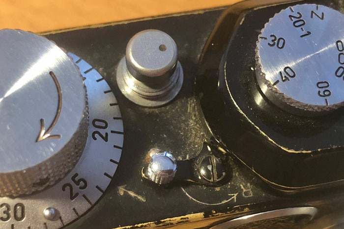

jerzy Posted February 19, 2021 Share #24 Posted February 19, 2021 vor 11 Stunden schrieb philipus: I've checked the rewind knob and it is not stiff. It turns easily pitty 🙂, I thought we will have simple solution for your problem. Still I believe thatr the problem is around canister/rewind axis/bottom cover.When you will have time you may check following - load film and wind as long as it will advance easily, lose the film in canister by rotating rewind knob in oipposite direction. Or, sacrifying oine film, advance film without bottom cover. Thx for posting photo of your camera, I missed it in the other thread. I love these clak paint/chrome conversion! Mine is not far away from your originally but a different model now Welcome, dear visitor! As registered member you'd see an image here… Simply register for free here – We are always happy to welcome new members! But now I am confused even more with your Leica - many details indicate postwar conversion as you wrote (matt film counter disc and release button, release button with dot, body shell from III with postwar vulcanite, etc) but why did Leitz messed with shutter not having it fully replaced? If you are interested in the history you may reach out to Leica Archive, they might have as well records about repair dates. Engravings on top plate (arrows, R, A) are still filled with Bismuth, I suppose, top cover is white paint. Do you have a notch on rewind lever like on left photo? Is there a screw like on the right photo? And Ambro has right - yes, I would like to have your camera in my hands 🙂 1 Quote Link to post Share on other sites Simply register for free here – We are always happy to welcome new members! But now I am confused even more with your Leica - many details indicate postwar conversion as you wrote (matt film counter disc and release button, release button with dot, body shell from III with postwar vulcanite, etc) but why did Leitz messed with shutter not having it fully replaced? If you are interested in the history you may reach out to Leica Archive, they might have as well records about repair dates. Engravings on top plate (arrows, R, A) are still filled with Bismuth, I suppose, top cover is white paint. Do you have a notch on rewind lever like on left photo? Is there a screw like on the right photo? And Ambro has right - yes, I would like to have your camera in my hands 🙂 ' data-webShareUrl='https://www.l-camera-forum.com/topic/317967-film-loading-trouble-in-leica-ii/?do=findComment&comment=4144390'>More sharing options...

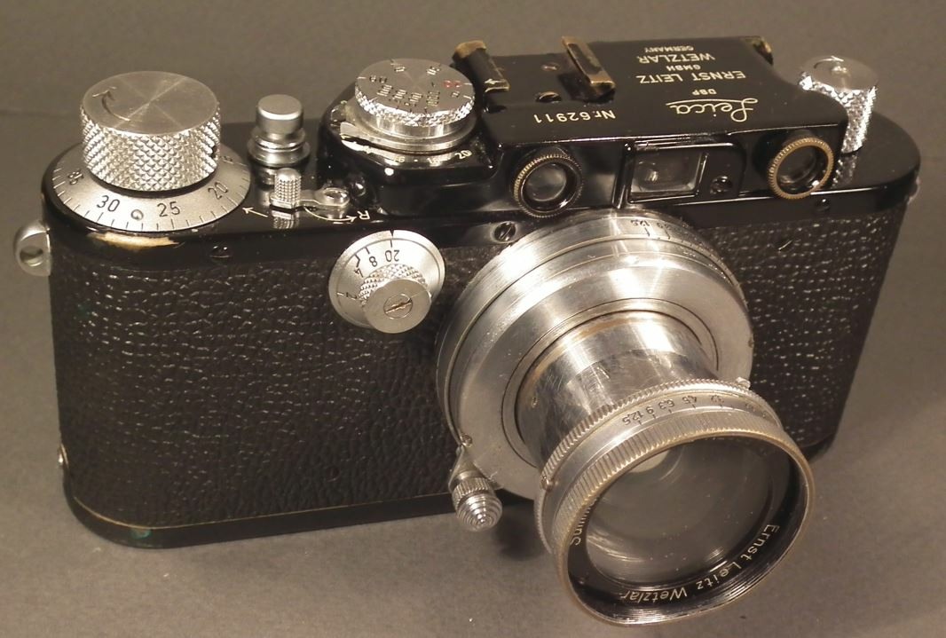

philipus Posted February 19, 2021 Author Share #26 Posted February 19, 2021 (edited) That's a lovely looking camera Jerzy, and very close in serial too. I also find conversions fascinating. It – the individuality of conversions – is what drew me to this camera in the first place. Well that, and the chrome-black combination which I find much more beautiful than nickel-black. I've checked with a roll and it is as you say, if I loosen the tension the film advance is much easier. At the beginning of the roll it's necessary to loosen the tension after around 5 frames, but further through the roll it has to be done every 2-3 frames and towards the very end after every frame. What could have caused this? I don't recognise this from before. As I mentioned earlier without film in the camera the rewind knob turns quite easily. There's a slight resistance, but not much, which I assume is because otherwise the knob would simply spin back due to the tension in the film roll. My camera doesn't have that notch on the rewind lever or that extra screw. Here's how it looks. Edit: What is the Leica Archive? Welcome, dear visitor! As registered member you'd see an image here… Simply register for free here – We are always happy to welcome new members! 35 minutes ago, jerzy said: pitty 🙂, I thought we will have simple solution for your problem. Still I believe thatr the problem is around canister/rewind axis/bottom cover.When you will have time you may check following - load film and wind as long as it will advance easily, lose the film in canister by rotating rewind knob in oipposite direction. Or, sacrifying oine film, advance film without bottom cover. Thx for posting photo of your camera, I missed it in the other thread. I love these clak paint/chrome conversion! Mine is not far away from your originally but a different model now But now I am confused even more with your Leica - many details indicate postwar conversion as you wrote (matt film counter disc and release button, release button with dot, body shell from III with postwar vulcanite, etc) but why did Leitz messed with shutter not having it fully replaced? If you are interested in the history you may reach out to Leica Archive, they might have as well records about repair dates. Engravings on top plate (arrows, R, A) are still filled with Bismuth, I suppose, top cover is white paint. Do you have a notch on rewind lever like on left photo? Is there a screw like on the right photo? And Ambro has right - yes, I would like to have your camera in my hands 🙂 Edited February 19, 2021 by philipus Quote Link to post Share on other sites Simply register for free here – We are always happy to welcome new members! ' data-webShareUrl='https://www.l-camera-forum.com/topic/317967-film-loading-trouble-in-leica-ii/?do=findComment&comment=4144404'>More sharing options...
jerzy Posted February 19, 2021 Share #27 Posted February 19, 2021 Advertisement (gone after registration) thx, everything, except one curtain drum is consistent with early postwar conversion, event the curtain brake - to be found in some conversion and few postwar IIIa only..... 1 Quote Link to post Share on other sites More sharing options...

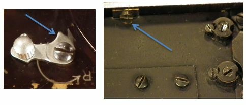

jerzy Posted February 19, 2021 Share #28 Posted February 19, 2021 sorry, I was too fast replying... yes, there is a notch on rewind lever of your camera and this is OK. As well missing screw holding the frame to the body shell. This means that as well the frame has been renewed during conversion and this is correct. But why not this one shutter drum? Strange..... Back to original problem - we know already where to look at, film travels correctly, there is no obstacle. It is the canister, or better to say spool in the canister being pressed by bottom cover what prevents the spool to rotate freely. Could there be anything that prevent canister to go fully inside? I do not see anything in film chamber what could cause it but you may check it when the film is loaded, wound 2 frames (so that you have full film width in the film frame). If you remove the lens, set time to Z and check if you see perforation in the upper part of frame. If you have another II/III you may swap the bottom cover to chek, but to be honest cannot imagine how the bottom cover could cause it. If anything else comes to my mind I'll come back Quote Link to post Share on other sites More sharing options...
