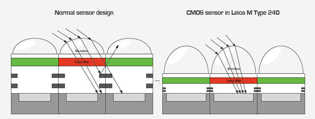

It has to do with two improvements. Reshaped (taller) microlenses over each pixel, and a shallower 3D structure in the silicon itself, that reduces "leakage" of, say, red-filtered light from a "red" pixel into a neighboring green-output pixel, or vice versa (or blue onto green and vice versa).
And technically, "similar mm" is not enough. The actual optical design has to be similar. The same coding will not work perfectly (or even at all) for: a 21 f/2.8 Elmarit from 1980, a 21 f/3.4 Super-Elmar ASPH from 2011, or a 21 f/3.4 Super-Angulon from 1970 (there is no coding at all that will work with the ancient Super-Angulon). It is why each specific model of lens has its own coding assigned.
