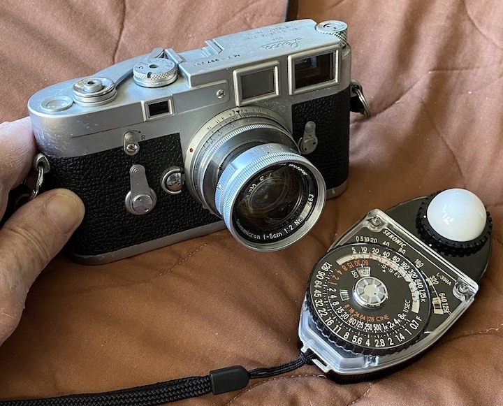

MikeMyers Posted January 9, 2021 Share #1 Posted January 9, 2021 Advertisement (gone after registration) I decided it would be enjoyable to buy some 35mm b&w film, and put my old M3 to use. The plan is to shoot the film, get the images developed somewhere, then scan them with an Epson V500Photo Scanner. The images would be processed in DxO PhotoLab 4. For starters, one lens - 50mm collapsible Summicron. Film will be Ilford Delta 100, 24 exposure rolls. I don't think I have shot film in maybe 15 years, maybe longer. My last film camera was a Nikon F4, which replaced an F2. I've got an M3 and a M2, but I love the viewfinder on the M3. For metering, I need to remember how to use my Sekonic. For anyone doing something similar, what resolution might be appropriate for scanning the images. I'm thinking 2400 dpi. Welcome, dear visitor! As registered member you'd see an image here… Simply register for free here – We are always happy to welcome new members! 6 Quote Link to post Share on other sites Simply register for free here – We are always happy to welcome new members! ' data-webShareUrl='https://www.l-camera-forum.com/topic/316851-leica-m3-images-to-be-scanned/?do=findComment&comment=4115245'>More sharing options...
