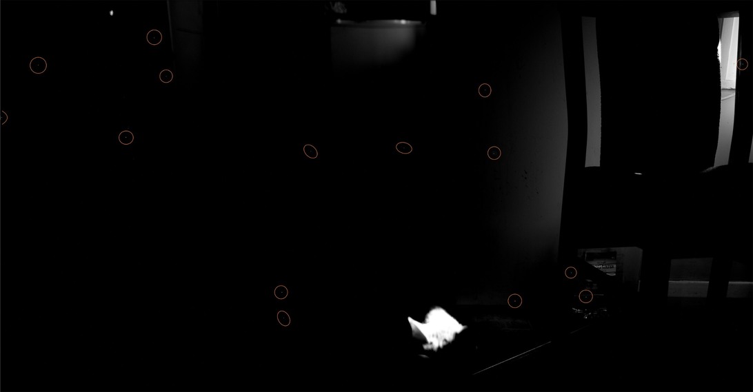

Hello all,
This is my first Leica (well, second technically) and I am having an issue where there are 5-6 "stuck" bright white pixels at ISO 800 and above, all located in different areas on the sensor. I had about 2-3 pixel issues on my first unit, returned it, and now am again having the same issue albeit in greater numbers. They are clearly visible even at 50% zoom, otherwise I'd be inclined to live with them, but it is quite annoying.
Is anyone aware of this being an issue with the Q2 Monochrom or this sensor type on other Leicas? Is there a general remedy, or does it look like I will be exchanging the unit again?
Thank you!
I've attached below a full sized shot with observed pure white pixels circled in red. I have also attached 100% crops of the image to further show how the spots appear in the image, confirming it is not dust or some other physical anomaly separate from the sensor. I have confirmed that between photos shot in another environment, and these, the white spots in exactly the same locations, which leads me to believe they're stuck pixels.
Again, I can only seem to observe them at ISO 800 and above, which seems less than ideal, considering the proposed high ISO performance of the Q2M. And although they don't appear as bad here (due to jpeg compression when exporting for the forum?) they are much brighter and annoying when editing, please trust me!
I am new to this type of forum attachment, so please advise if the images are not easily viewable. Thank you!

darn- they are indeed visible in your shots - a bit hard to spot on image #1, but then very clear with the magnifications.
I took a look at some shots in dgn and jpeg at 800 iso and a copple way higher and I don't see those white spots/pixels. sorry for your troubles. What is Leica saying about this? It seems they admitted fault/problems as they replaced your camera, but did they offer any explanation at all?
And are these spots always in same exact locations? I am not an expert, just wondering if this phenomenon will occur at other isos and even with different processing software...

Thank you for this suggestion. I was recommended to contact Leica by the shop who sold me the camera, in an effort to obtain a firmware update to resolve hot pixels. The person I spoke to at the shop said Leica M sensors often have this issue, which I was not previously aware of, and cannot determine if this is true. The manual does not mention any function similar to the one you mention that’s available on the Olympus.
I just took a test exposure of 1/60 @ 1.7 ISO 2500 with the lens cap attached, and count 21 bright white pixels in total which seems high for a $6,000 USD camera.

@nwphil I am not an expert with technical experiments, but I can mention that my first experience with the camera was taking miscellaneous photos around the apartment, familiarizing myself with macro mode, autofocus behaviors, et cetera. Upon zooming in to 100-200% levels in Lightroom to observe the resolution (pixel peeping I suppose) I noticed that some images exhibited the white dots, and others did not. Upon further review, I noticed that they occurred regardless of aperture or shutter speed, and that they definitely occurred in any exposure using ISO 800 and above.
After noticing the issue, and in an attempt to most clearly illustrate the issue with Leica, I took two images with the camera in Manual mode, Macro mode disabled, and the lens cap attached and manual focus set to nearest distance. One exposure was 1/60 @ f/1.7 ISO 800, and another 1/250 @ f/8 ISO 250,000. Both images, when viewed in Lightroom, appeared identical in terms of the intensity of the white dots, and their location. To me, this meant that aperture and shutter speed was not important in producing these artifacts, but confirmed that the ISO does. Subsequent exposures, regardless of aperture, shutter speed, or focusing distance produces these dots. Once the ISO is adjusted to 400 or lower, they are absolutely invisible.

30 minutes ago, SrMi said:
I can see hot-pixels on my Q2M as well. They are not visible at ISO400 or less.
Many cameras have an option to remap hot/stuck pixels, but Leica cameras do not.
Alas, I was afraid of this. Like I mentioned earlier, I know not every sensor is perfect, and could have lived with a few stray pixels here and there, but this is noticeably worse than what I experienced with my first unit and I suppose is a little disappointing. I would have kept the first unit had I known.
Thank you for your input!
Apologies to everyone with the constant updates, but I reviewed the sample images from DPReview's initial review of the Q2M and when importing the RAW files into Lightroom, I observed the exact same behavior, which I suppose concludes that the issue I am experiencing is normal for this camera.
If Leica contacts me with any additional information I will update this thread, but I wanted to conclude the discussion with an observation that both confirms and validates the behavior, and I am assuming it is no cause for concern.
