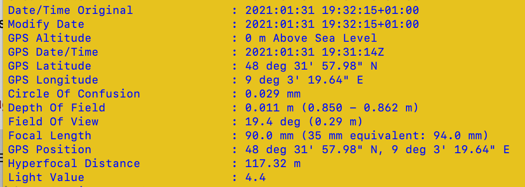

HI, I'm running EXIFTOOL, but whenever I try to read GPS data (i.e. exiftool -gpslatitude xxx.jpg or exiftool -gps* xxx.jpg) I get "Bad length ICC_Profile (length 3144)".
Running exiftool without parameters shows the exif data, but no GPS info are there
vor 2 Stunden schrieb US00678:
...that's very interesting! Until know I didn't use the -gps tag, only running exiftool without parameters. Here's an example (DNG-file from SL2 with GPS-icon).
But when running exiftool -gps don't get any information, nothing.

Am 8.2.2021 um 13:54 schrieb MediaFotografie:
Are you invoking exiftool from a Linux (Unix) shell? If, you need to either specify the tag name without spaces (case does not matter), for example,
exiftool -hyperfocaldistance L1000247.DNG
results in
Hyperfocal Distance             : 35.38 m
If you want all tags starting with 'GPS' you do
exiftool -'GPS*' L1000247.DNG  (or exiftool -"GPS*" L1000247.DNG) to yield
GPS Version ID                  : 2.3.0.0
GPS Latitude Ref                : North
GPS Longitude Ref               : West
GPS Altitude Ref                : Above Sea Level
GPS Time Stamp                  : 13:30:06
GPS Status                      : Measurement Active
GPS Measure Mode                : 3-Dimensional Measurement
GPS Map Datum                   : WGS-84
GPS Date Stamp                  : 2019:04:06
GPS Altitude                    : 0 m Above Sea Level
GPS Date/Time                   : 2019:04:06 13:30:06Z
GPS Latitude                    : 42 deg 20' 28.41" N
GPS Longitude                   : 71 deg 4' 51.90" W
GPS Position                    : 42 deg 20' 28.41" N, 71 deg 4' 51.90" W
Otherwise, the wildcard (*) gets interpreted by the shell, produces an empty string, and exiftool sees the option as -GPS. Since there is no tag literally called "GPS" in the DNG file. you will see nothing:
exiftool -GPS* L1000247.DNG
exiftool: No match.
I hope this helps! - Matti
