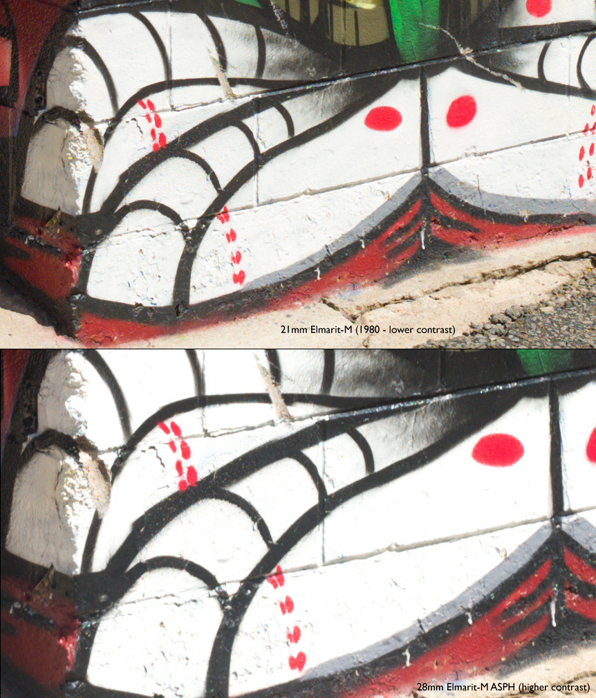

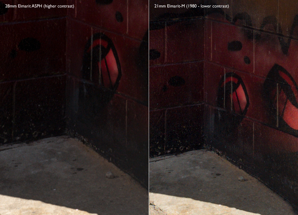

adan Posted September 25, 2020 Share #38 Posted September 25, 2020 On 8/28/2020 at 10:59 AM, SrMi said: ETTR is a technique to be applied in low contrast images when the DR of the scene is smaller than the DR of the sensor. This is the key point. For me, low-contrast scenes are things that mostly only happen to other people. Between the electric contrast range of daytime pictures under Colorado's raw direct sunlight and thin air, and nightime or indoor pictures with bright artificial light sources (or windows) and pools of shadow within the same picture, and the wide tonal range of a dawn/dusk sky behind a dim foreground, the percentage of low-contrast situations I encounter can be counted on the fingers of one hand (<5%). Add to that my subjects are generally fast-moving humans, where the entire taking of the picture (including metering) has to happen in a couple of seconds, and I "EFTR" (expose for the right - the highlights) most of the time. Default -0.7-stop autoexposure. (Plus, I do get a little extra help from using the older, lower-contrast 1980s Mandler lenses whenever possible - at least an extra stop of DR between darkest shadows and blown highlights) But with the M10 I do use a rough-and-ready version of ETTR with the rare low-contrast (in the shade) subjects I find interesting - a thumb-swipe of the exp. comp wheel to +0.3 to +0.7. And I have even started using OETTR (overexpose to the right) when the setting and subject demand it. In the extreme-contrast-range picture below, the rich dark tones far outweighed the importance of the windows, and I was perfectly happy to blow the windows through the roof for the maximum in shadow gradation. Again, a quick thumb-swipe to +1.5 EV. Great photography is not about following a rule. It is about choosing and adjusting the many rules - to suit the situation. Welcome, dear visitor! As registered member you'd see an image here… Simply register for free here – We are always happy to welcome new members! 1 Quote Link to post Share on other sites Simply register for free here – We are always happy to welcome new members! ' data-webShareUrl='https://www.l-camera-forum.com/topic/312751-ettr-when-and-why/?do=findComment&comment=4051761'>More sharing options...

pgk Posted September 25, 2020 Share #40 Posted September 25, 2020 7 hours ago, adan said: (Plus, I do get a little extra help from using the older, lower-contrast 1980s Mandler lenses whenever possible - at least an extra stop of DR between darkest shadows and blown highlights) Sorry Andy but you don't and we've had this argument before. Older Mandler lenses record less tonality not more. The reduced contrast is a result of veiling flare and the deepest shadows are not tonally separable. This is regardless of the scene's dynamic range. If you don't believe me just try a very old lens such as an early TTH Cooke. It cannot record the tonality that a modern lens can because it clearly lacks shadow detail which is masked by veiling flare - even on a triplet. Using it in high contrast conditions tends, if anything, to increase veiling flare and record less tonality. Quote Link to post Share on other sites More sharing options...
