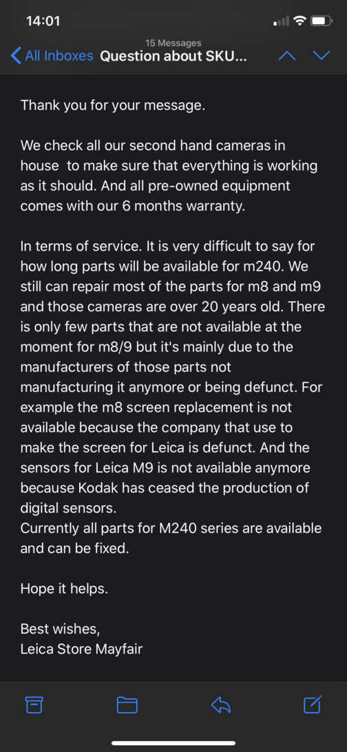

The main problem here is if an M7 goes wrong (due to electronics) then Leica aren't able to repair them as there are no more parts available. Whether any independent techs can make up new pcb's or whatver is another matter.
I'd be hesitant to spend that kind of money of a camera that might not be repairable, especially when you can probably find a really nice M6 or maybe even an MP for the same money. The M7 is the only film M with auto exposure though. The M6/MP have meters but the shutter is totally mechanical.
Do you know that as a verified fact or are you just speculating? I know the model has been discontinued but I do not recall Leica stating that they can no longer repair the camera.
