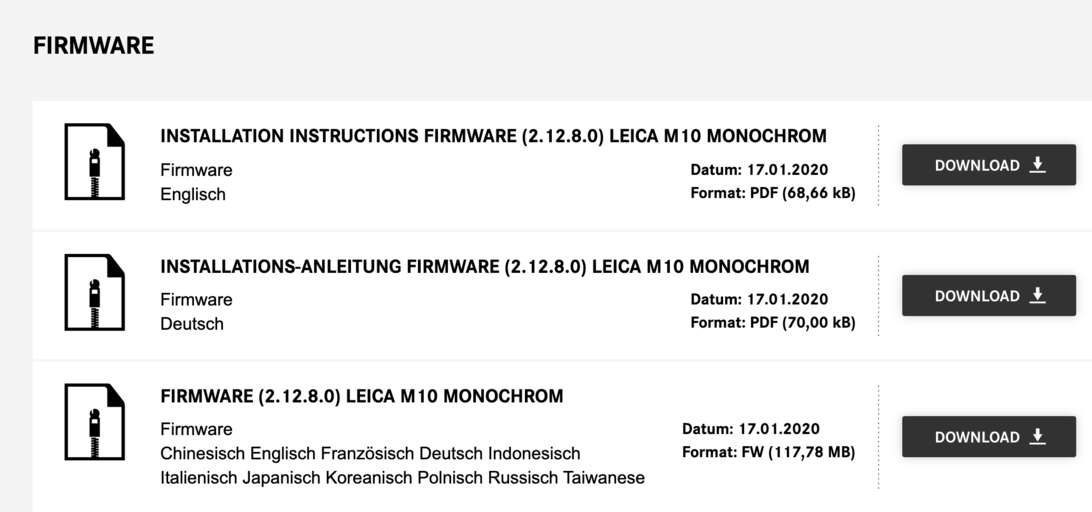

strohscw Posted August 1, 2020 Author Share #7 Posted August 1, 2020 (edited) Advertisement (gone after registration) vor 3 Stunden schrieb dkmoore: Did you make sure you have the latest firmware? Mine was shipped with older version firmware and needed to be updated. Yes, at least it´s the one I have access to: Version 2.12.8.0 Today I tried another SD-card. At the moment I have a new theory about this issue: It happens only when using my M10M with the EVF and a fast SD-Card. I tried different brands and the only one of my cards that work are the Sandisk 128GB with 95MB/s, today I tried it and haven´t had one camera freeze. During the last weeks I tried my Sony Tough cards 256GB 277MB/s and the Sandisk 128GB 170MB/s with both I had many Camera freezes per day. So, I am not sure anymore if it is a question of brands it looks more as a question of speed. I know that this is not very scientific but as long as Leica is not giving us a solution for this problem, I can only try to find myself a solution that works at least for me. Edited August 1, 2020 by strohscw 3 Quote Link to post Share on other sites More sharing options...

dkmoore Posted August 1, 2020 Share #9 Posted August 1, 2020 3 hours ago, strohscw said: Yes, at least it´s the one I have access to: Version 2.12.8.0 Today I tried another SD-card. At the moment I have a new theory about this issue: It happens only when using my M10M with the EVF and a fast SD-Card. I tried different brands and the only one of my cards that work are the Sandisk 128GB with 95MB/s, today I tried it and haven´t had one camera freeze. During the last weeks I tried my Sony Tough cards 256GB 277MB/s and the Sandisk 128GB 170MB/s with both I had many Camera freezes per day. So, I am not sure anymore if it is a question of brands it looks more as a question of speed. I know that this is not very scientific but as long as Leica is not giving us a solution for this problem, I can only try to find myself a solution that works at least for me. That is not the latest firmware. Go to leica.com and update. That may resolve your troubles. Quote Link to post Share on other sites More sharing options...
strohscw Posted August 2, 2020 Author Share #10 Posted August 2, 2020 vor 6 Stunden schrieb dkmoore: That is not the latest firmware. Go to leica.com and update. That may resolve your troubles. Very interesting, when I go to Leica.com and look for the M10 Monochrome Firmware I find only this: Welcome, dear visitor! As registered member you'd see an image here… Simply register for free here – We are always happy to welcome new members! To what version and where do You have access? Thanks! Quote Link to post Share on other sites Simply register for free here – We are always happy to welcome new members! To what version and where do You have access? Thanks! ' data-webShareUrl='https://www.l-camera-forum.com/topic/311710-when-is-leica-stopping-the-m10-monochrom-freezing/?do=findComment&comment=4019804'>More sharing options...
dkmoore Posted August 2, 2020 Share #11 Posted August 2, 2020 7 hours ago, strohscw said: Very interesting, when I go to Leica.com and look for the M10 Monochrome Firmware I find only this: Welcome, dear visitor! As registered member you'd see an image here… Simply register for free here – We are always happy to welcome new members! To what version and where do You have access? Thanks! 10.20.27.20 I just used the drop downs on the leica website and it took me right to it. https://us.leica-camera.com/Service-Support/Support/Downloads?category=93710&subcategory=187020&type=108942&language=all Quote Link to post Share on other sites More sharing options...
dkmoore Posted August 2, 2020 Share #12 Posted August 2, 2020 Crap, I was thinking M10R firmware. Sorry for the confusion on my end. Quote Link to post Share on other sites More sharing options...
strohscw Posted August 2, 2020 Author Share #13 Posted August 2, 2020 vor einer Stunde schrieb dkmoore: Crap, I was thinking M10R firmware. Sorry for the confusion on my end. Anyway, thanks for trying! Quote Link to post Share on other sites More sharing options...
