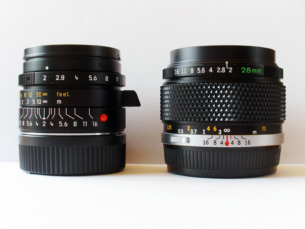

One must use thicker adapter with SLR lenses. I like much my OM lenses though.

Yeah you're right, but for focals over 70mm or so, it's not much of a difference, because even on SLRs they don't need to clear the mirror box. So the extra length of the adapter for an SLR lens is already kinda "built in" in the RF glass. The adpater starts adding bulk in lenses <40mm imo.
And I agree, Olympus glass is amazing when it comes to compactness. A single digit OM body with a "typical" lens is tiny by SLR standards. Especially the wideangles. Or the rare as hen's teeth 40mm f/2, which is almost a pancake.

It is the same adapter for any SLR lens with the same mount of course. I have no Olympus adapter on hand but my Leica R to M one must be about 20mm thick. Add to this about 50mm for a Zuiko 100/2.8 and the overall length will still be taller than a Tele-Elmarit 90/2.8 (62mm) let alone a Macro-Elmar 90/4 (59mm). Same calculation for a Zuiko 40/2 (25 + 20 = 45mm) compared to the Summicron 40/2 (less than 25mm). And this to get an adapted lens unable to focus in RF mode on M cameras...

As no doubt you're aware, the thickness of an adapter can be calculated as the difference between the flange focal distance of the lens mount and that of your camera's mount. So a Olympus to Fuji mount is 4.6-1.77 = 2.83 cm. For Leica M its 2.78-1.77 = 1 cm. With the different adapters required, as lct reports, I still make the Olympus slightly heavier (by ~35 g), wider in diameter (by 1 cm) and longer (by 7 mm) than the 90/4s. Yes, I am being fussy... but my best photos come from the lenses I carry most often, which - experience has taught me - is always my smallest ones... image quality is important but secondary. Case in point, the Fuji 90mm/f2 - premium IQ, too big, too heavy, barely ever used it! My most used lenses currently are my native pancake 27/2.8 and also tiny 35/1.4, which happily are lenses I also like in terms of IQ. A few years ago it was my 18/2, which I was never actually that keen on, but for its tiny size.
