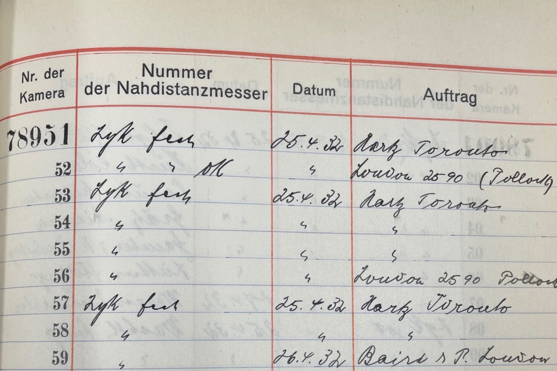

vor 10 Stunden schrieb derleicaman:
I don't think OK means OK in the terms we are used to it. OK or Okay, came into common use post-War in Germany. I am almost certain it was not use as we think of it in the 30's.
As a German native speaker, I fully agree. Back then, it is highly unlikely that "ok" would have been used in the sense of "in good order". It must have some different meaning here, the more so since in the Leica ledgers shown above "ok" is anteceded by two quotation marks, such that the full line actually reads "Lyk feet ok". If "ok" would mean "in good order" (corresponding to what 'ok' means today), then why would most of the cameras listed in the book not be ok? That does not make sense, so "ok" certainly designates something else here.
I will post the full page later. I have also seen the page which Giulio mentions. The camera may have been subject to an extra check for some reason. It is working perfectly now 91 years later.
William

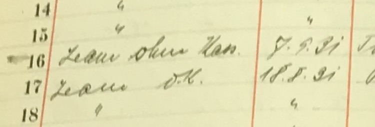

I think the o.k. may stand for ‘ohne kassette’ (without cassette)
Edited by Giuliobigazzi
Error
Posted (edited)
vor 34 Minuten schrieb Giuliobigazzi:
Based on your above image, where it says, in line 16, "ohne Kass.", and in line 17 just says "o.K.", it seems perfectly clear that "o.K." is indeed an abbreviation of "ohne Kassette". Well done!
vor einer Stunde schrieb willeica:
That may have been the case, but it is still most unlikely that "o.K." or "oK" (note that the records indicate "oK", and not "ok"!) was used in the sense of todays meaning of ok. See Giulio's post above, which to me clarifies what "o.K." means.
Testimony of a quality product!
Edited by wizard
addition of text
I think this pretty much nails it! Ohne Kassette abbreviated “Ohne Kass.” And then on the next line O.K.
Reading the handwriting and then the abbreviations in the delivery records can be quite a challenge!
Re my comment on LYKUP being body only. This is what I have read in books,  but actually there are also entries marked LYKUP o.K so maybe originally this was also with cassette included. There are also LYKUP 2.5, that will at some point later changed to LYHEK.

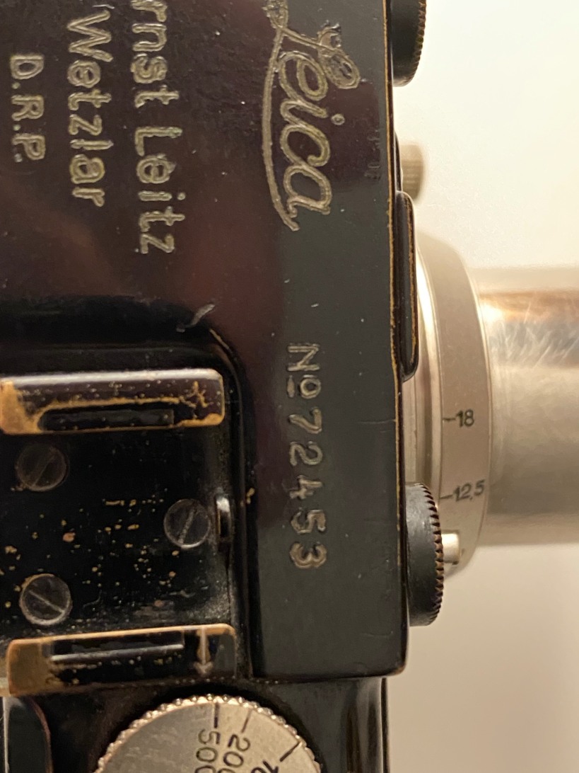

On 10/20/2022 at 1:32 AM, Giuliobigazzi said:
Here is 72401. Delivered on 14.11.1931, I have heard of no earlier. There are design differences so probably pre production/prototype. If earlier serial II’s were originally assigned to Ic’s this would explain why such an early example bears a slightly higher serial than expected. Camera is a Leih-Kamera Ia, so this delivery date would apply to the top plate only. Still unclear why or how these two parts came together.
Great article in vidom 125 about this camera, @Giuliobigazzi
