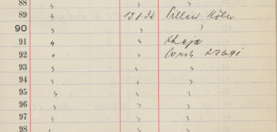

willeica Posted March 28, 2022 Share #21 Posted March 28, 2022 Advertisement (gone after registration) 1 hour ago, Pyrogallol said: This is the page Leitz sent me for my Leica 11, 89397, originally black but now chrome. Welcome, dear visitor! As registered member you'd see an image here… Simply register for free here – We are always happy to welcome new members! That camera must have been the one that went to Perrot near Bern. I'll see what I can do to see the complete delivery registers for 1932 the next time that I am in Wetzlar. It would seem that there were quite a few I Mod As and I Mod Cs in the 7xxxx range, but I have not seen very many of them. The jump between February and April 1932 is quite remarkable and the cameras issued in that period could not have all been IIDs as Alan has pointed out. William 1 Quote Link to post Share on other sites More sharing options...
