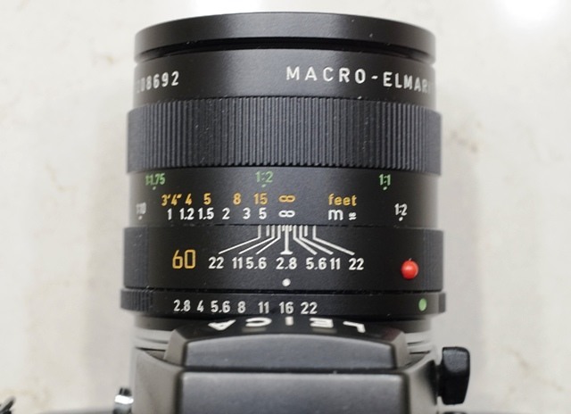

Carl54 Posted May 17, 2020 Author Share #8  Posted May 17, 2020 (edited) No kind of attachment, doesn't look like it's ever been dropped. Here's a photo: Welcome, dear visitor! As registered member you'd see an image here… Simply register for free here – We are always happy to welcome new members! Edited May 17, 2020 by Carl54 Link to post Share on other sites Simply register for free here – We are always happy to welcome new members! ' data-webShareUrl='https://www.l-camera-forum.com/topic/309639-60-macro-problem/?do=findComment&comment=3975170'>More sharing options...
msh58 Posted May 17, 2020 Share #9  Posted May 17, 2020 vor 11 Minuten schrieb Carl54: No kind of attachment, doesn't look like it's ever been dropped. Here's a photo: Welcome, dear visitor! As registered member you'd see an image here… Simply register for free here – We are always happy to welcome new members! Hello, Looks like there is something wrong with the focusing mechanism. The front flange should be closer to rest of the barrel. Does the focusing work smoothly? Is the front part loose? It should be easy to get this lens serviced. It is a wonderful all-around standard lens, good for close ups, too. Link to post Share on other sites More sharing options...
TomB_tx Posted May 17, 2020 Share #10  Posted May 17, 2020 The lens has been disassembled and the helical focusing thread was not indexed correctly when re-assembling. It is a multi-start thread and can be mated in a number of positions, but only one is correct. Likely the grease had thickened making it hard to turn, and someone tried to put in lighter grease. (Mine was very hard to focus when I bought it used, and I had DAG correct the issue.) A Leica tech such as DAG could fix it quickly and at reasonable price. Here is how it should look at infinity: Welcome, dear visitor! As registered member you'd see an image here… Simply register for free here – We are always happy to welcome new members! 2 2 Link to post Share on other sites Simply register for free here – We are always happy to welcome new members! ' data-webShareUrl='https://www.l-camera-forum.com/topic/309639-60-macro-problem/?do=findComment&comment=3975179'>More sharing options...

Carl54 Posted May 17, 2020 Author Share #12 Â Posted May 17, 2020 The lens works smoothly, feels right. Yes, I noticed the flange didn't come all the way back. Now that I know what DAG is, I'll be contacting them. Thanks everybody for your help! Link to post Share on other sites More sharing options...
